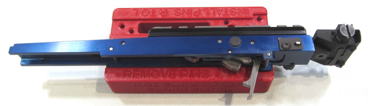

I have my 3D printed MG2 slide cover bench block up on Thingiverse now: https://www.thingiverse.com/thing:6662216
The Summary includes notes on how to use it. It's labeled so you drive the pins in the right direction, and it will accommodate pistols that have one of Jon Eulette's optics rails installed.

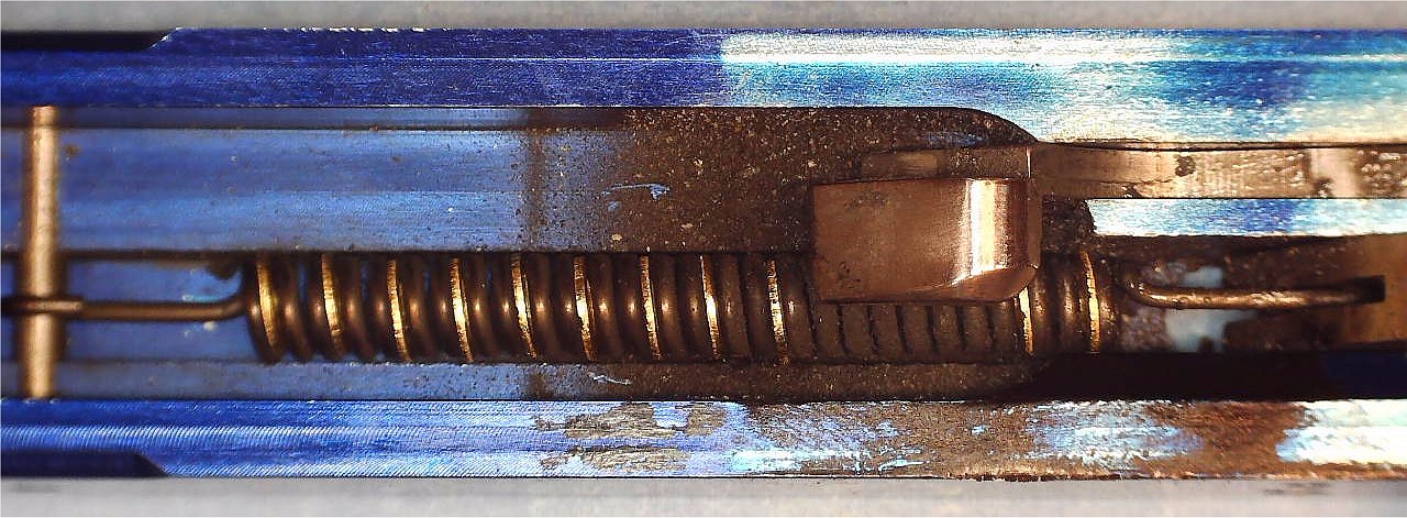

The springs can break. I've had to replace one once (with 3 pistols in service). There is a weak point introduced when the form the hooks, and I sent that info to the factory to see if they could get their spring maker to fix that, but I have no idea if they did that, or how many older springs are still out there in pistols.
Replacing it (or the "bullet insert lever" BIL) is a pain in the neck. I can dig up my notes, but won't be making a video until I have to go through the process again.
There are a couple things that make the process easier. The 3D printed bench block is essential. I also like these punches: https://www.amazon.com/gp/product/B0085V67VW.
The trick that really helps if the hammer spring is intact (like when replacing the BIL) or when you need to install a new one is to stretch the spring by inserting a bunch of small washers between the coils.

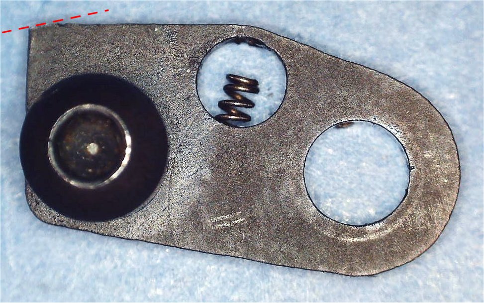

I've run into the slide lock problem as well. Some slides seem to sit lower than others, and can catch the edge of the lock. I put a slight bevel on the corner of the lock. That prevents it from snagging during cycling, but it still has plenty of engagement for manual operation.
I've also had to apply LocTite to the side plate screws.
The US importer has reported that some people have had issues using the O-ring buffer, but I'm not sure what the failure mechanism is. All three of the MG2s I have don't seem to be affected. Eventually, the slide in my wife's MG2 cracked, even with the O-ring. The replacement slide is much thicker over the barrel, but I've still got the O-ring installed.

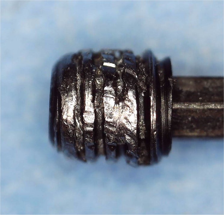

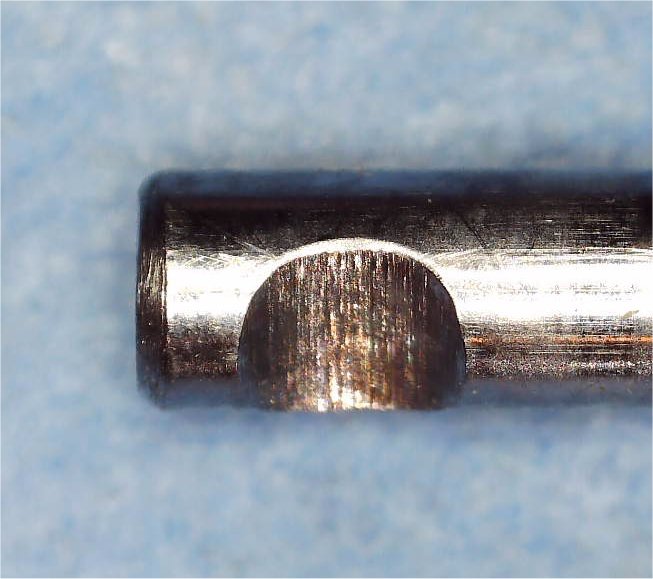

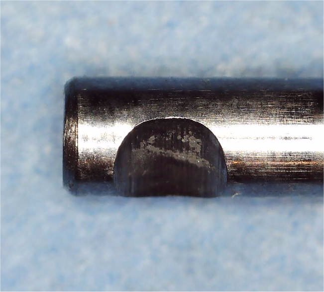

The problem with the set screw is that the pivot pin for the carrier is free to rotate a bit. The groove that is ground into the left end is not a tight fit, so as the carrier operates, the pin rotates back & forth. The pin is hardened, and the factory makes no attempt to break the sharp edges on the pin. As a result, those edges dig into the screw threads and damage them.
Here's a photo of the screw that came out of my first MG2 when I removed the carrier for the first time:
What I have done since then is to stone down the sharp edges on the notch in the pin to reduce the damage. Here are before & after pictures of the pin:
When I've removed the carrier since then, the damage is minimal, but I still occasionally replace the set screw if it feels the least bit rough coming out. From an industrial supplier, a bag of 100 is $10 USD, so it's cheap insurance.
