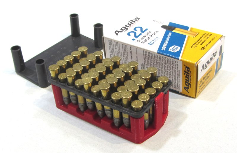

The first set of designs is for "cartridge lifter" blocks that hold .22 long rifle cartridges in staggered rows of five for easy loading. Here's what the one for Aguila ammo looks like:
I've got designs for Aguila, CCI, RWS/Norma, and SK/Lapua.
Here's the Thingiverse link: https://www.thingiverse.com/thing:6564327
This is the only multi-file posting I've done there. I think it's all set, but please let me know if any of the files are missing or messed up. There is a Zip file that has all the STL files, as well as STEP files if someone wants to edit them.

Thank you very much for those! I found one for Federal Champion ammo but that doesn't quite fit for the European (RWS etc) brands.
Posts: 3581
Re: .22 LR Cartridge Lifter Blocks
I designed one for Federal 711B a while back, but I've found their ammo to be useless in most of my pistols, and I'd forgotten I have a file for it. The recoil of the 711B is too weak (and variable) to operate any of my semi-autos, and it gets my free pistol dirty so fast I have to clean the chamber half way through a match to extract it.
I hadn't run across Federal Champion. It appears to be made in the USA, so they may use the same cartridge carrier. I added that design to the Thingiverse collection.
One caution about the RWS design: The students seem to break the latches off more often on that model than the others. I don't know if it's the students involved, my print settings, filament, or the design. The cross-section of the latches isn't that different from the others. My suspicion is that the students who've used it aren't careful not to overflex the latches. One student in particular left a trail of damaged gear wherever he went. Fortunately, he graduated...
