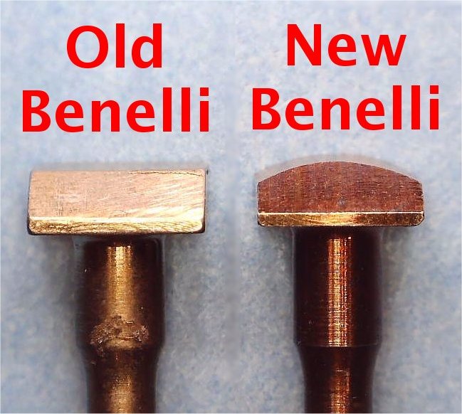

About a year ago we needed to get parts for our sixteen Benelli Kite air pistols. I now have a contact at the factory who helped us with that, and he is also very familiar with the .22 pistols. I sent him an email with a description of what I'd observed, and my attempts to fix it. He immediately came back with an email that our firing pins were too long! They made a design change to the "head" a while back to try to reduce breakage, and at the same time decided to make them a bit longer. Here's a picture that shows the two versions:
The old firing pins were 31.1 mm from the front of the head to the tip. The new design was 31.3 mm long.
I inventoried all our pistols, and found seven that had replacement firing pins that were 31.3 mm long. All of them had a history of being fussy, or in some instances, completely unusable. I cleaned them, and test fired them with 20 rounds of Aguila standard velocity ammo. One had no failures, but the remainder had at least 3 jams. The worst one had 13.
Apparently Benelli had discovered this problem a while ago, because the newest batch of 6 replacement firing pins I had were all 31.1 mm long. They have the same head shape as the newer ones, but they are a silver color, rather than the brown finish of the older ones. I cleaned the six pistols that had jammed during test firing and installed the short firing pins.
Yesterday, we test fired those pistols. Five of the pistols did not jam at all firing 40 rounds of Aguila. One had some feeding issues, which were eliminated by swapping magazines. Afterward, that pistol also fired 40 rounds without a problem.
The hammer pushes on the back of the firing pin through the early part of the recoil cycle. The only thing I can figure is that the firing pins are so long that they are actually pushing the fired cases off the extractor. We have one pistol that can apparently tolerate that to some extent, possibly because its extractor has a larger gap, or other tolerances build up to act in its favor.
This has been driving me nuts for quite a few years, and I know some other Benelli owners who have struggled with the same symptoms. If you only have one pistol, it could be nearly impossible to track this down on your own. I also found that some of the firing pins made & sold by Larry Carter can be as long as the bad factory ones, and two of the pistols we fixed had those installed.
I hope this helps other Benelli owners out there. I know one local shooter who sold his two Benellis because he had so many problems with them. He has since discovered that he just can't shoot his Pardini as well as the Benellis, which matches my experience.

If the pin doesn't stick out too much, the bevel on the tip usually takes care of pushing the pin back into the bolt. I don't know that I have ever seen a pistol misbehave due to dirt build up in the firing pin channel, but it's certainly possible.

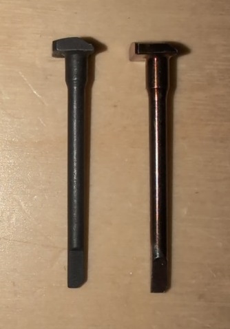

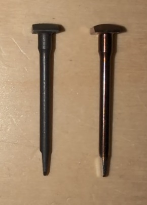

The black firing pins are probably Larry Carter's. They have a sort of hemispherical head, rather than cylindrical. I found them to be less prone to breaking than the original factory pins. The curved head is intended to eliminate off center strikes that can snap the head off over time. Larry made a big deal about working with a metallurgist to pick a better steel and heat treating process than the factory used. I've had the various alloys analyzed, and I've done hardness testing, and there's not a huge difference. About the time Larry was running low on his pins, the factory came out with their pins with the cylindrical head geometry. Most of the failures I've seen are pins breaking near the tip, which is pretty much the same geometry on all the different versions.

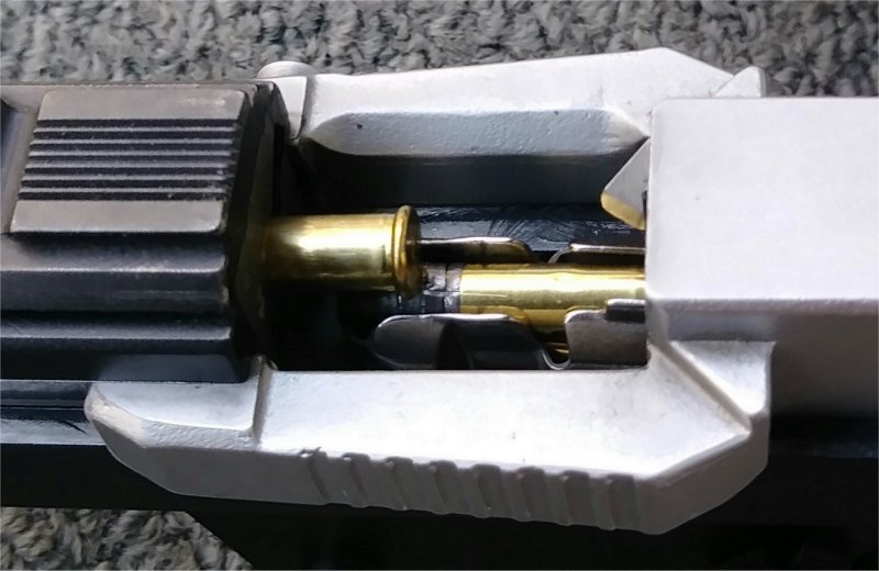

In my case, the rounds failed to chamber properly, because the rim end failed to rise before the bolt jammed the cockeyed cartridge forward. The channel was pretty gummy owing to me trying some extra-greasy ammunition. I discovered a paper Q-Tip shaft is a perfect fit for cleaning! :)
Thanks, it seems so, the mushroom is curved in both directions (black/LGI on left, brown/Benelli on right). The dark gray one is the same shape, I guess it's an LGI but has a less thick coating/anodizing.The black firing pins are probably Larry Carter's. They have a sort of hemispherical head, rather than cylindrical.
I observe that the LGI pin has significantly more bevel at the lower edge of the tip. The lighting is a bit tricky in the photo but it's quite noticeable in hand. This particular pair measure LGI=31.04mm, Benelli=31.18mm.

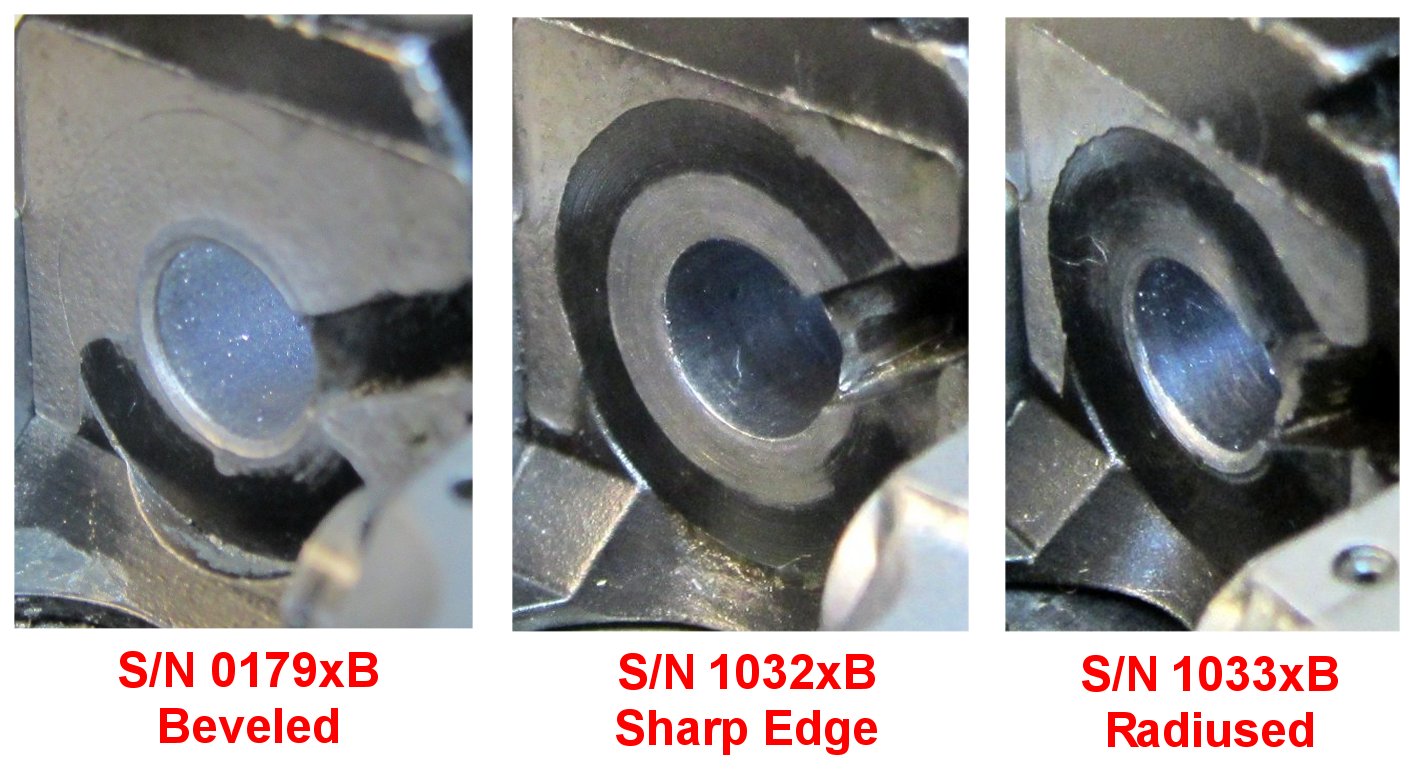

I sent a note to my contact at the factory, and asked about the feeding issues we have had with some pistol/magazine combinations. No real info on that, but I got some more info on the firing pin issues.
Apparently, Benelli decided that they needed to radius the rear of the chamber edge a lot more than they had done in the past. In 2009, they changed the chamber design to include a significant radius. I've never seen one, but I suspect they basically added a bit of a feed ramp to the lower edge of the chamber. Pardini has a really large feed ramp on their pistols, but the firing pin strikes at the top of the rim. On the Benellis, the firing pin hits at the bottom of the rim, and they found they had to increase the firing pin length by 0.2 mm to get reliable ignition.
Our latest Benellis were bought before 2009, and have serial numbers in the 103xxB range. We have 5 that were all bought at the same time. They all arrived with VERY sharp chamber edges. Unless you can find just the right magazine or shoot extra pointy ammo, they shave lead off rounds when they feed. I've been slowly stoning a small radius at the top & bottom of the chambers, and that helps considerably. At least now I know not to get too carried away or I will need to get longer firing pins.

My MP90S was bought in 2016 (date code = "CP" same year), it had very little radius and no visible ramp. I had the same issue with "dinging" the nose and my gunsmith throated the entry by adding a slight radius all around with a felt bob, it has nearly eliminated the issue. And there have been no light strikes or other side effects, and no long pins.
So I'm confused - was this change reverted post-2009?

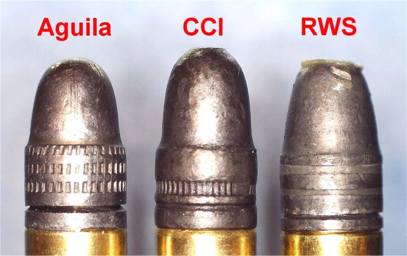

One thing we've found over time is that fussier pistols will often work better with RWS Target Rifle ammo than with CCI or Aguila. I always thought is was due to the recoil characteristics. Recently, I was chasing some feeding issues, and I took a look at the bullet shapes, which are quite different:
The shoulder between the driving band and the ogive on Aguila is fairly abrupt. CCI is a little less so, and the longer bullet tip may help to guide the rounds into the chamber better. The RWS has almost no shoulder at all. RWS Target Rifle was costing us ~ $1,000 a case (when we could find it), and apparently it is no longer being imported to the USA. However, Norma TAC-22 is supposedly equivalent. It has the same bullet shape, and it costs ~ $350 a case, which is only slightly more than we pay for CCI. Depending on what remaining issues we find now that the firing pins aren't a problem (I hope), we may lay in a stock of Norma ammo & see if that helps.
