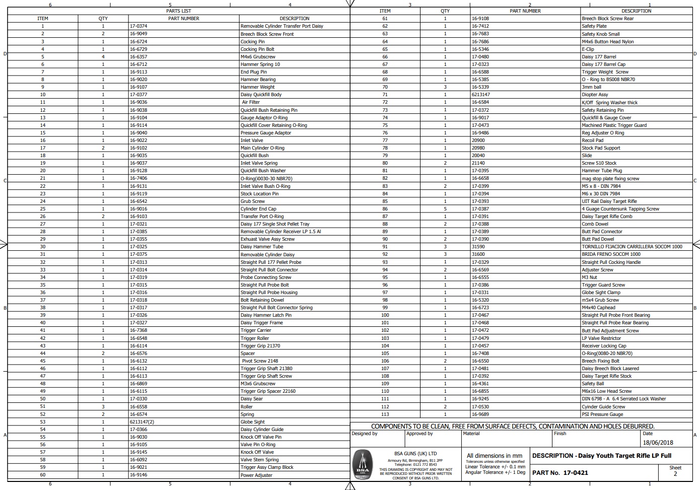

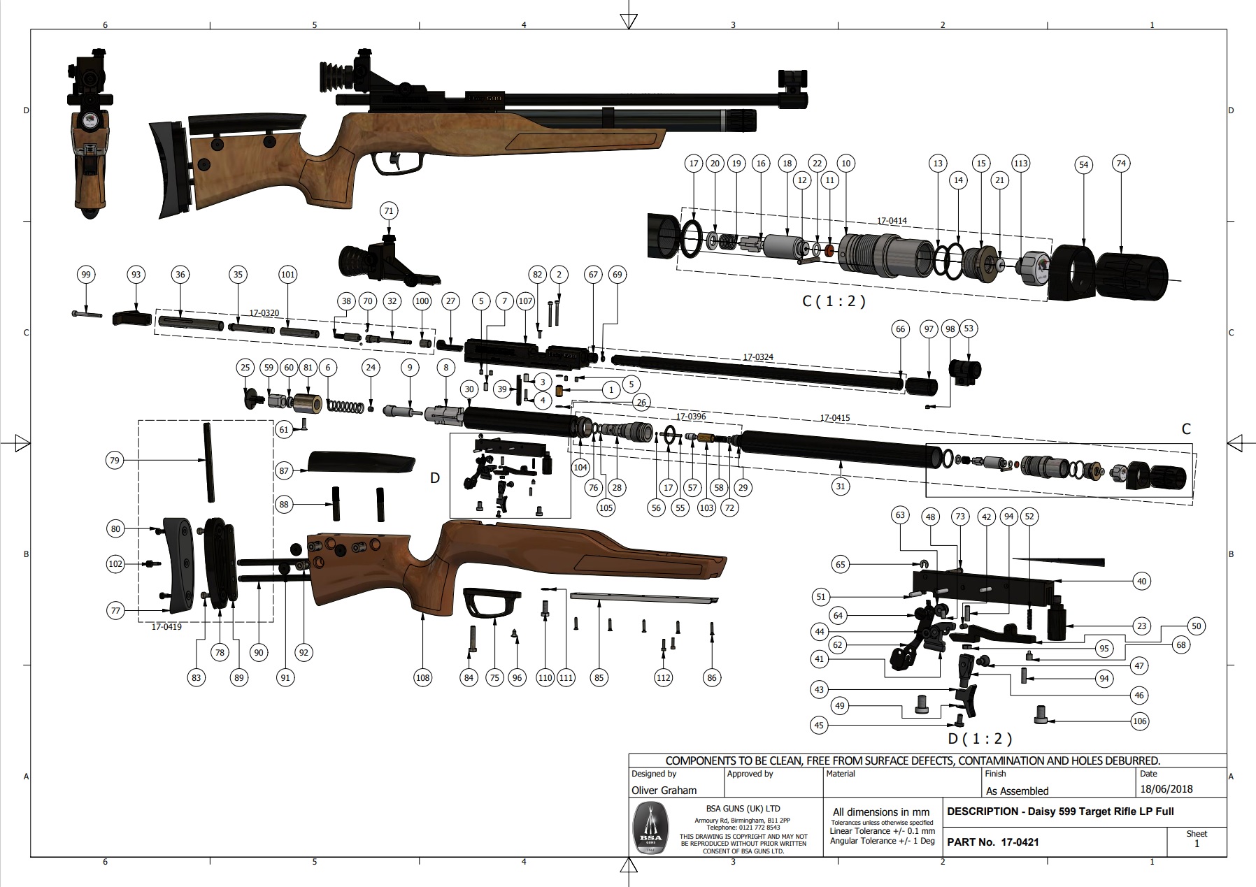

We just ordered some parts and Daisy sent this diagram with updated price list. After looking over the pdf more carefully it appears it's missing a lot of information.

Yeah, It's a pretty good diagram. The bubbles are pointless though as they don't appear to be referenced on the parts list. Thanks for the PDF. It's high res so that helps.

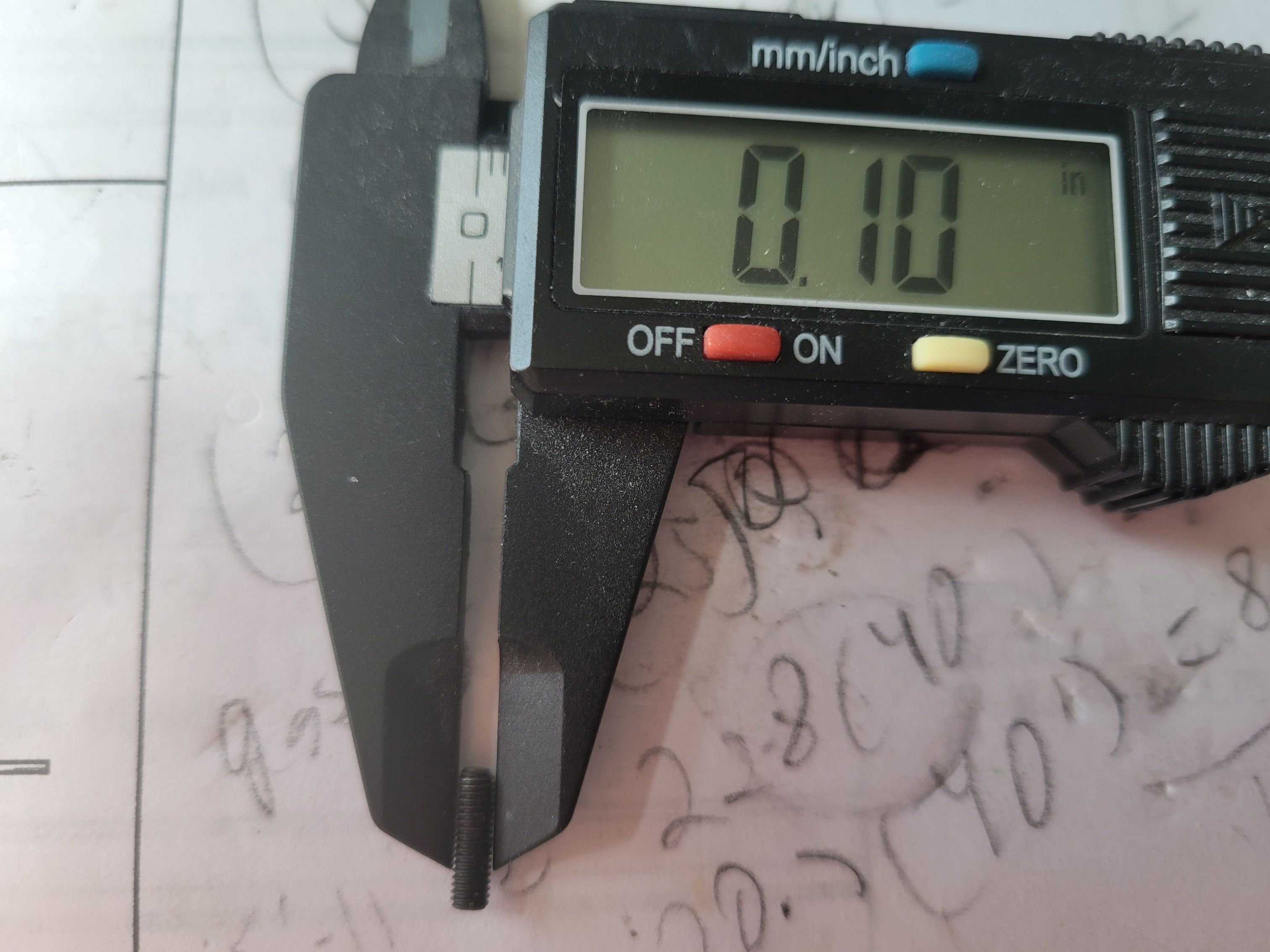

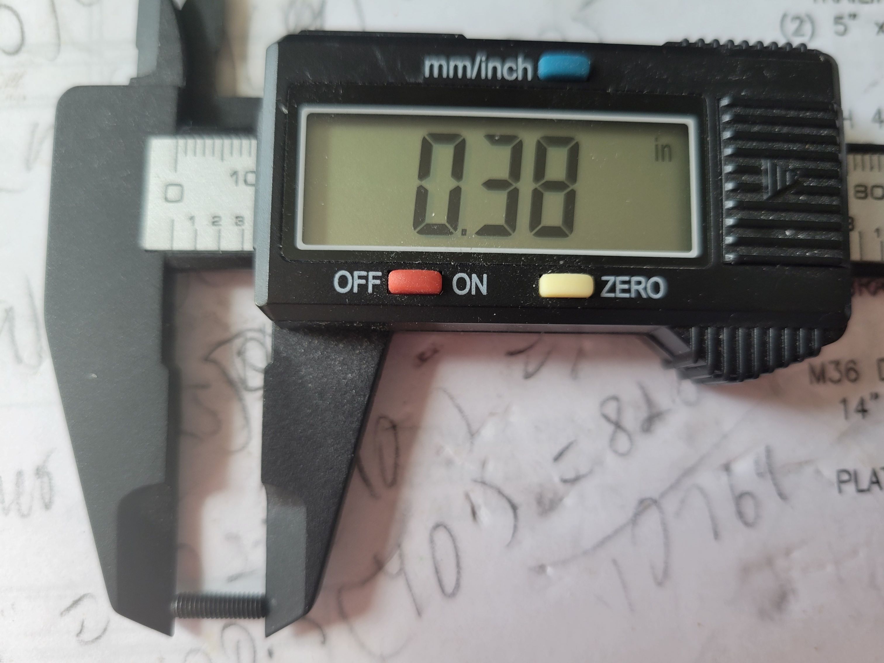

here are a couple of pictures of the screw for dimensions. My aging eyes can't tell if its a #3-48 or #3-56 x3/8" long, considering every other item listed is a metric screw/nut then maybe a M2.5? Either way i've loaded the pictures so you can decide for yourself.
