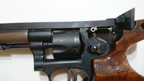

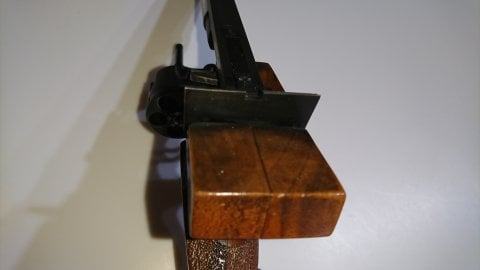

Hi Tony,

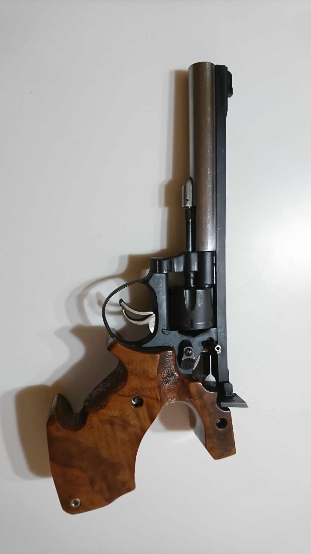

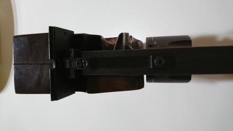

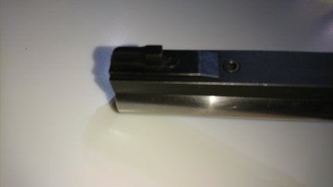

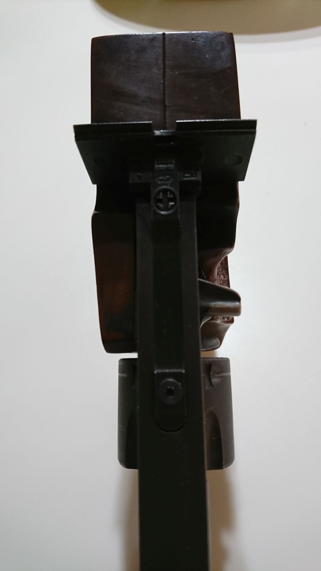

I have a custom built S & W mod 36 with the Millett rear sight & custom wide blade fitted ( plus a custom made foresight too) and it does make it easier to align and sight the target.
s & w 1.jpg (8.19 KiB) Viewed 24492 times
s & w 2.jpg (11.29 KiB) Viewed 24492 times
s & w 3.jpg (18.23 KiB) Viewed 24492 times
s & w 4.jpg (10.12 KiB) Viewed 24492 times

dino911 wrote: Fri Feb 09, 2024 7:36 pm Hi Tony,
Wow, that is really something! Very original and purpose-built.
Can you share more photos?

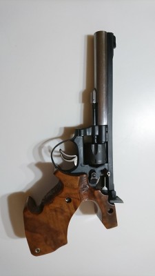

6string
Posts: 463
Re: S&W 14 rear sight
Post by 6string »

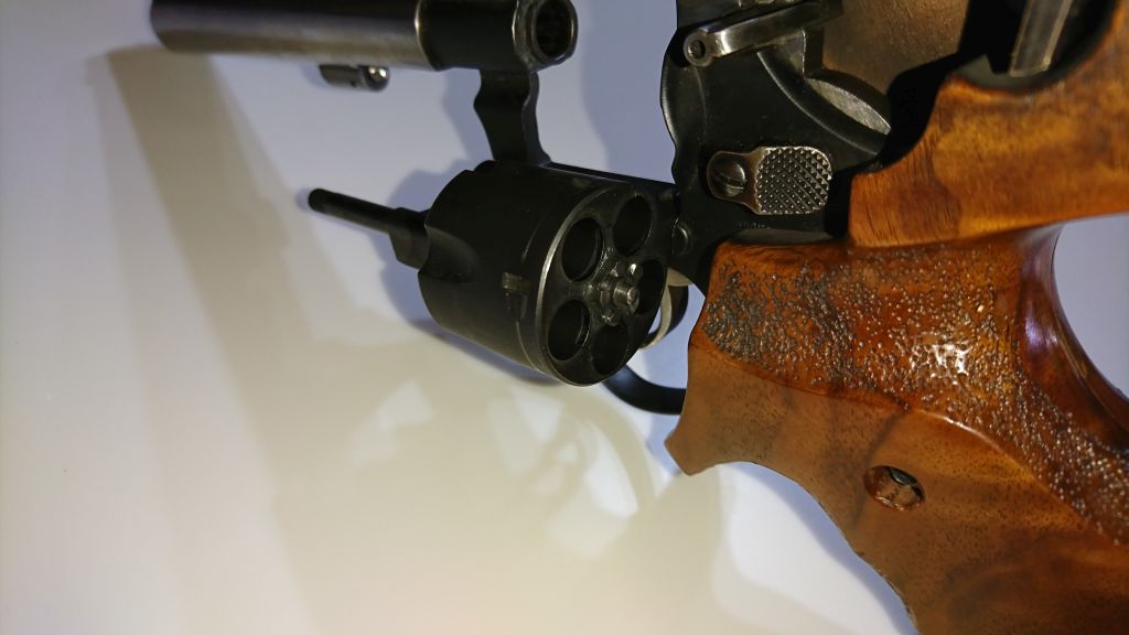

Thanks for taking the extra photos. This looks very well thought out. I like the high grip and the way the sight line sits so low. It looks like you’re using a Pardini SP GRIP.
What is going on with the “two triggers”? Is the forward one shaped to account for the change in grip and trigger reach?
Some other things appear self explanitory, such as the trimmed cylinder for full wadcutters.
Clever hammer extension for the left hand!
If you’re on the S&W forum, I bet they’d love to see your nicely modified m36!

This was custom built by Graham Millett after he and Barry Cameron had thought out the design ( both late of Blacktown Pistol Club, Sydney Australia). The grip was made by Barry Cameron so that the hand position was similar to a semi-auto centre fire ISSF pistol - and the cocking lever added to make fast cocking easy. The trigger needed the " trigger shoe " added for reach and is single action only. It has one of the last Tony Lissner 38spl barrels made. Shortened cylinder for wadcutter target loads. All in all a very accurate ISSF centre fire pistol. :)

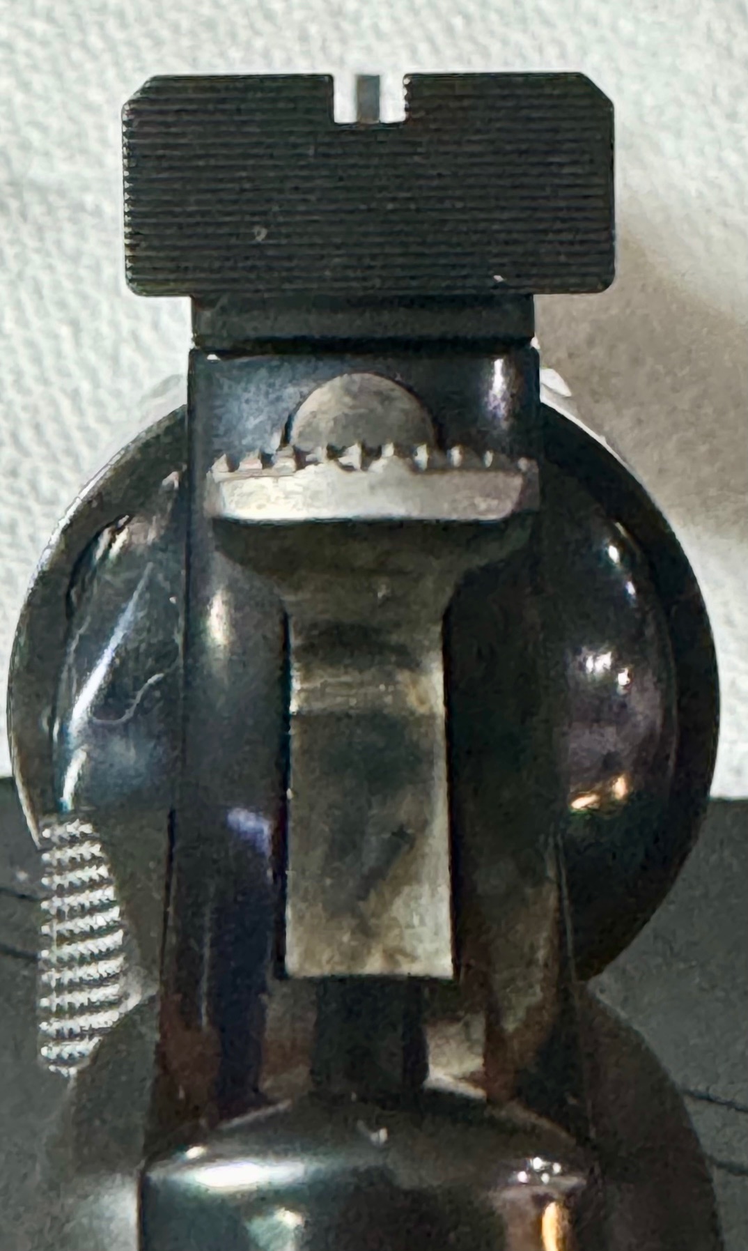

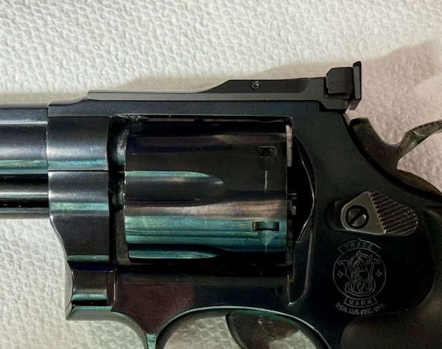

Here is what I came up with on my Model 14-7 with the LPA sight. The picture of the sight picture is not what it looks like at arm’s reach it is much tighter. I will probably open mine up a bit with a safe edge needle file.

K38 wrote: Mon Jun 03, 2024 9:13 am Here is what I came up with on my Model 14-7 with the LPA sight. The picture of the sight picture is not what it looks like at arm’s reach it is much tighter. I will probably open mine up a bit with a safe edge needle file.
In any case the the LPA rear sight blade is much bigger and blockier and much more like a modern target sight. The instillation was very easy just remove one screw to take off the factory sight, clean the screw holes and install two screws to put on the LPA sight.
