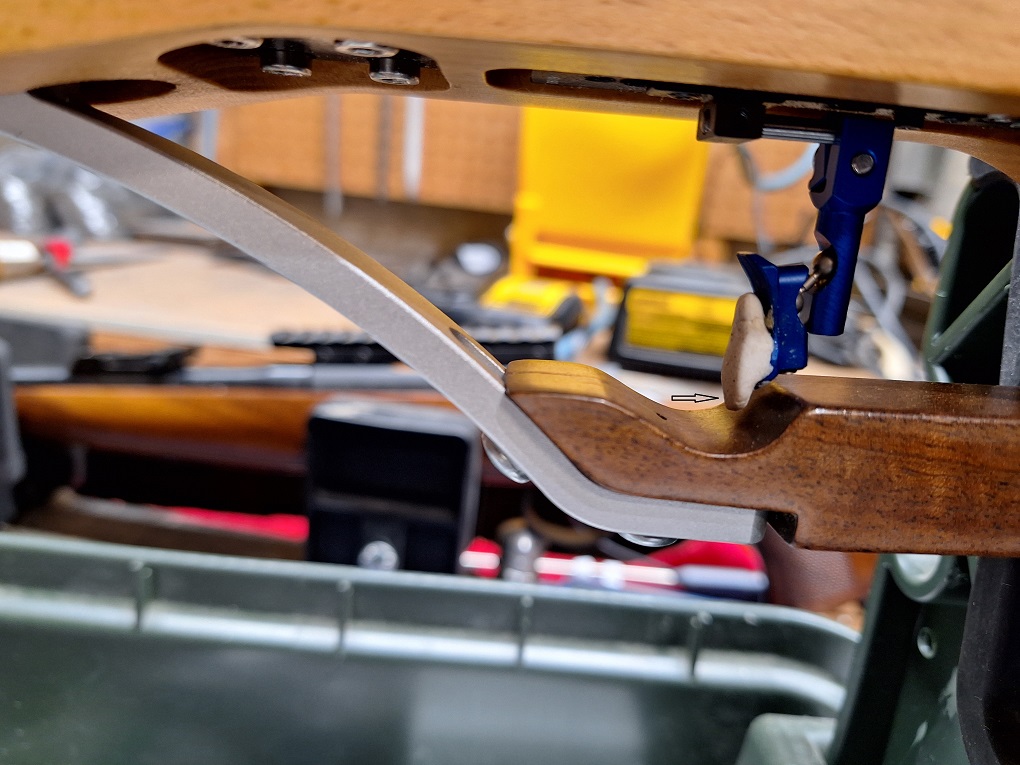

You can reduce pull weight by extending the lever. It will not affect the internal operation of your trigger or sear. I believe triggers are tested
at the center of the lever, so moving your contact point to the cusp will reduce the effort required as well.
Gerry

Nicolas, I call it a shoe. I've got a Senseive that I've adjusted as far down as possible with a lump of modeling clay on the cusp. Probably twice as far from the fulcrum as designed.
I doubt any of y'all would be comfortable with 6 grams.
Gerry

would it be possible to have a photograph of your modified trigger cue?
Thank you, Gerry.

Weird , huh? I'm not insane. I shoot benchrest and the only thing I come in contact with on the entire apparatus is the spot indicated by the arrow.
gerry

Gerry,
thank you very much for the photograph.
