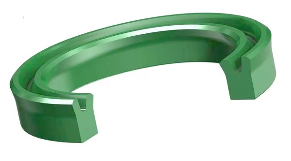

If it's a regular round O-ring, it may be hard to find an exact replacement, but again, you can almost always find a substitute that will work. There are fancier seals that some manufacturers use that are probably harder to substitute. Benelli (and I believe Morini as well) use a "hydraulic rod seal" for the air cylinder seal the mounting pin goes into. They are also called "U" seals, and they look like this:
All of the seals Benelli uses have Parker part numbers, except one. Its the firing valve seal, and it's another another U-seal, but in a red material. It's smaller than the cylinder pin seal, and may be a softer urethane than the Green stuff. Because it's doesn't have a Parker number (or any other vendor info) and it does have a Benelli part number that matches their in-house manufactured parts, my best guess is that it's non-standard, and is probably made by Parker for Benelli. That doesn't mean Parker hasn't added it to their catalog since the design was requested. The good news is that I've never seen one fail (so far). At some point I want to measure one and see if I can figure out what they are using.

I have seen seals like that in hydraulic rams and most motorcycle forks I have rebuilt, some have a tension spring in the groove. Having worked in manufacturing equipment building most of my life, I don't think I ever saw an engineer design anything that they couldn't buy off the shelf. We work with Parker Hannifin on applications, but have yet to give them our design to make custom. Some our equipment might cost more than all the Kites ever made, I can't think there were enough Kites sold that it would justify a proprietary seal that was only ever used just there. Benelli may well have used a design that was hard enough to find that it encourages people to send their guns back, or pay $25 for a $3 seal.

The big expense in making seals is the mold. With CNC manufacturing, the costs on even that have gone way down. Lots of places now advertise that they can make custom size O-rings for reasonable prices, even in very limited qualtities.
It's possible Benelli specified the U-seal for the Kite firing valve using a standard size part (mold), but in a different material from stock.
