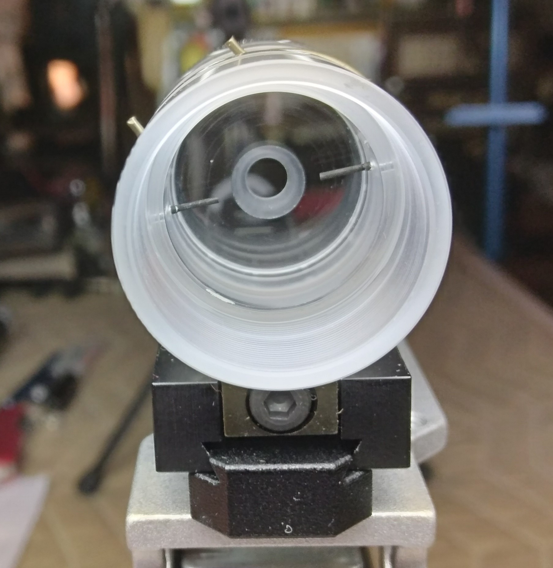

This one fit, measured as 0.530 long distance, but as picture shows , the long distance is elevated, had a good solid feel when mounting it.
I need some time with the horizontal wires, to see if I want to use them or take them off.
justadude
Posts: 803
Re: Which Globe
Post by justadude »
Looks like a MEC 'Crystal' on a FWB dovetail. Regardless of the exact brand, it looks proper and secure.
The wires do help with getting a consistent cant from shot to shot. While I cannot say you absolutely MUST leave them, I would highly encourage leaving them and getting the globe rotated so the whiskers are level when you are in position. Then develop your shot process to remember to look at them as you settle in for each shot.
'dude
