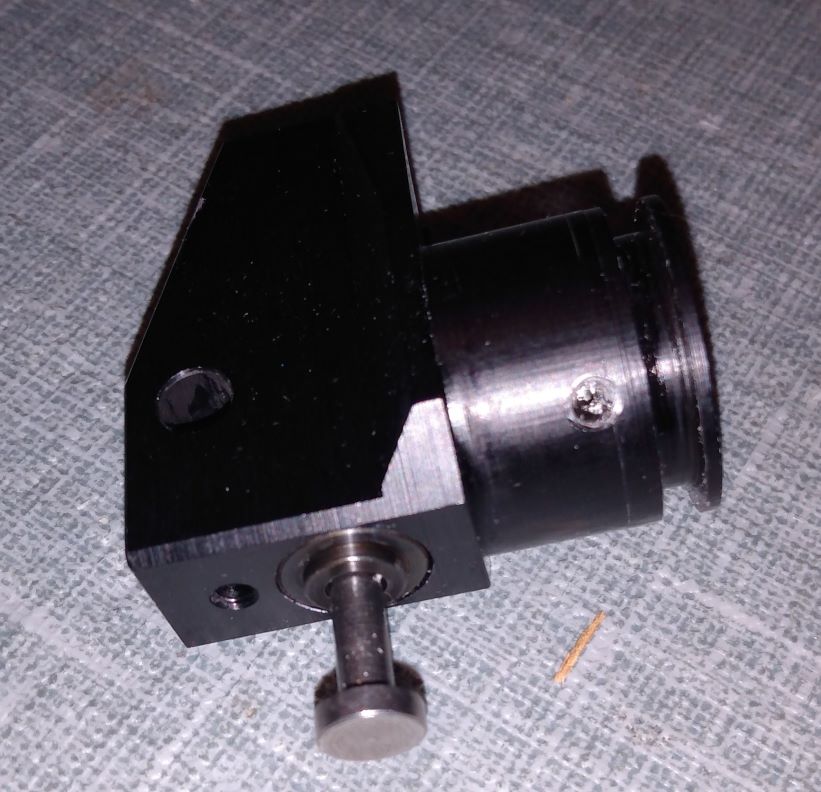

I have disassembled my FAS604 into the basic components.
Now I am stuck.
How do I remove the plunger in the photo to replace the O-Rings?
marky-d
Posts: 231
Re: FAS604 Repair
Post by marky-d »
Pull hard.
Mine was stuck pretty badly -- the o-ring had turned to paste. I don't remember what I finally used to get it out; I think I may have used a piece of wood or brass to wedge under the 'button', then levered it against the body.
