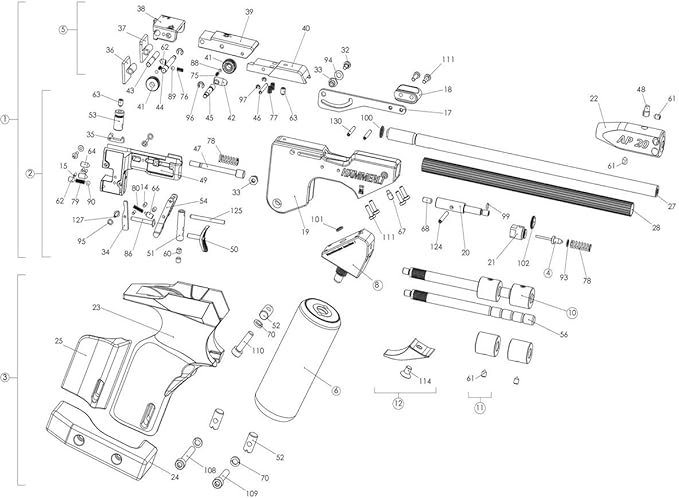

We've started up again this fall, and a minor issue I've noticed in the past appears to be spreading and getting worse. On most of the pistols, when you lower the cocking lever, there it a bit of resistance as you close it, and then the cocking lever snaps down into place. It feels consistent with a toggle linkage going "over center", but mechanically, that's not the way it works. I don't have one in front of me, but the diagram shows a small shelf in the slot of the cocking lever that might provide that last little "step" in closing force. The resistance may be the O-ring on the bolt seating in the breech.

I have a brand new one, just out of the box, in my hands. It has a definitive half-cock, and full cock status. Perhaps look at either spring #78 having lost tension, due to wear? When enough tension is on the bolt the cocking handle should not pop up. I do not believe the cocking lever has anything to do with the issue you report. They really are great pistols. overall. We have 4, now. Please let us know what you find.

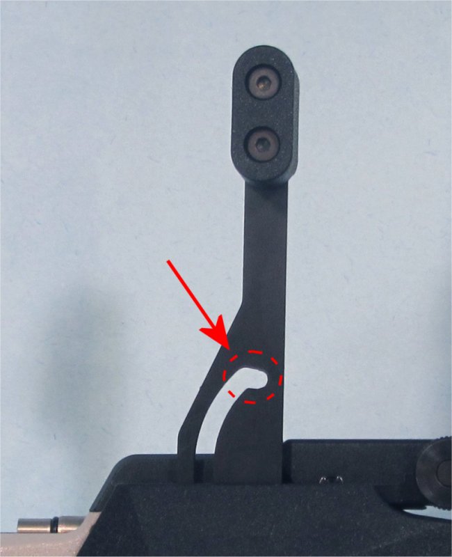

Once it's cocked, the striker spring #78 is held by the pawl system, and shouldn't have any effect on the cocking lever. I have a picture of the cocking lever that shows that the cross pin through the bolt should effectively "latch" into the front of the slot where it hooks backward slightly:
Cocking Lever Notch.jpg (53.02 KiB) Viewed 20006 times
What I don't know is what might prevent it from latching. If the notch is worn, I could see it would be a problem. Also, if the lever is prevented from going down far enough for the bolt cross pin to fully seat in the notch. The bolt has to provided some backward force to stay in the notch, and I don't know if that is just from compressing the O-ring, or if a spring is involved somewhere.

I checked over 20 of our pistols, and basically NONE of them actually "latch" in any positive way. The lever just goes down and stops. The only pistol I found that seemed to have any positive latching action is one I switched to left handed, and the lever is rubbing on the inside of the grip. That pistol has had very little use compared to most of the others.
There doesn't appear to be any significant wear on the "notch" at the end of the cocking lever slots. There is some variation in how much force it takes to work the lever, but that's about it.
I thought there was at least a small latching feel to the levers when they were new, but either I imagined it, or the levers were rubbing on the inside of the grips and that has all smoothed out.

The o-rings don't have enough elasticity to change out?
By looking at the diagram that appears to be what provides rearward pressure since the barrel does not look like it has opposing set screws like Steyr.
