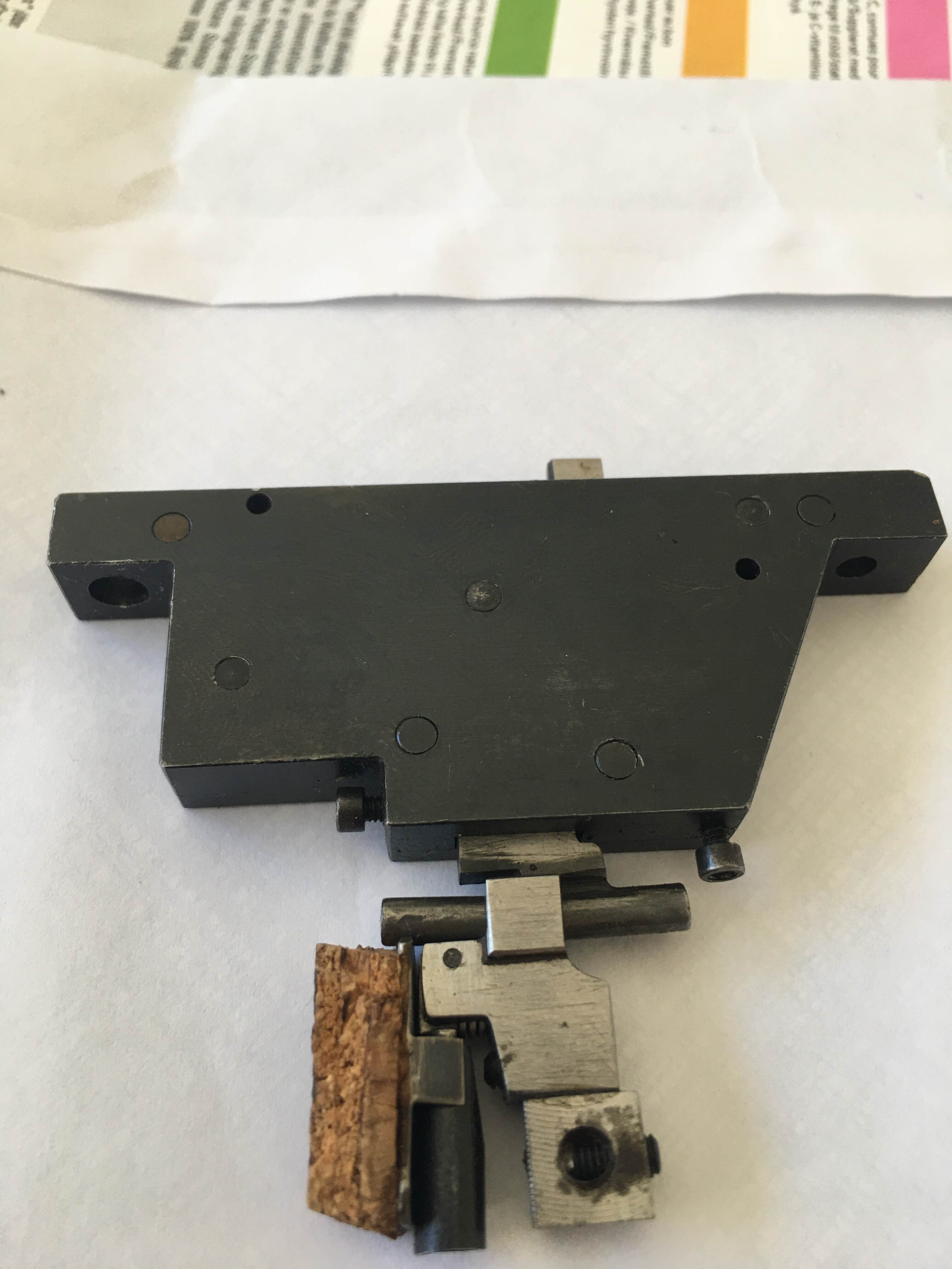

I have a K KENYON trigger that was used by one of your great shooters. Here are some photos. I don't know what rifle it fits on, maybe an Anschutz?
Can you tell me more ?
Thank you for your help.
Sportingly.
Nicholas.

Your trigger looks very much like Kenyon triggers I had that were made for Anschutz 54s. It's not a very early trigger, as those had an external adjustment cam, but I can't say if it would fit a 14/16xx or an 18/29/20xx bolt.
The trigger blade, or shoe, does not look original.

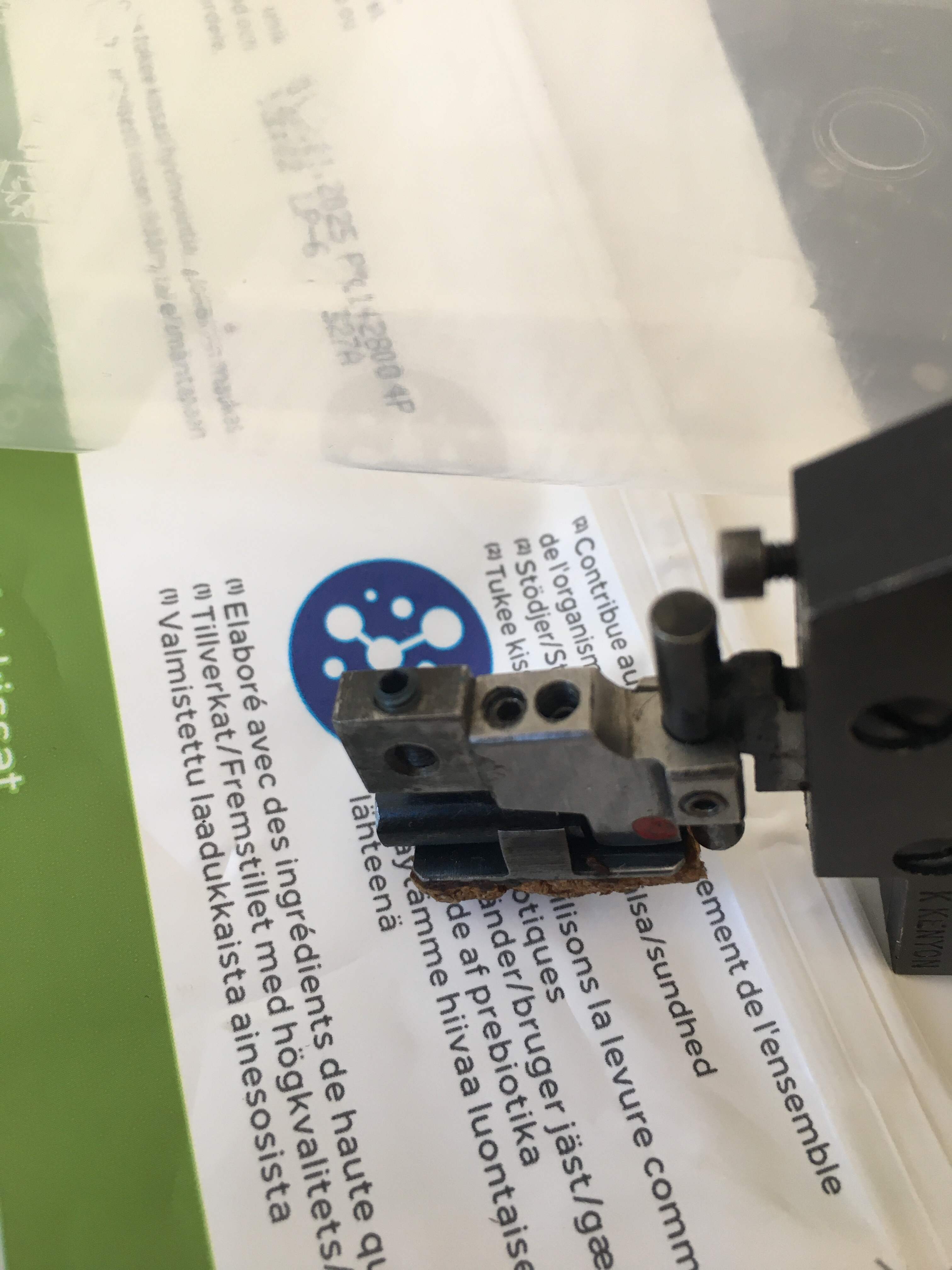

the trigger shoe appears to be built to act as a 2 stage, my guess, and it sure doesn't look like anything Kenyon would have put together. Kenyon triggers were, and continue to be in a class all by themselves, finest ever made. It is an earlier trigger due to the case being blue. If you would like a copy of Kenyon's instructions for that trigger, I could email you a copy

That's right, there's a bump before the hard point.
As I mentioned, this mechanism belonged to a great US champion. It may have been a special order from Karl KENYON ? I don't think my friend modified it.

Karl Kenyon did make a spring loaded trigger shoe to give the feel of a two-stage release. I have a 1913 barrel/action built by Karl in 1993/94, which I'm told came with this pseudo-two stage. Sadly the original owner wanted a true two stage, and replaced it with a 5018.

we're talking about the same trigger. It's direct, but there's a device that gives the sensation of a bump. I think it's a beautiful object.

I had several of the “two stage” trigger shoes on Kenyon triggers a few years ago and they looked very close to the one pictured. I know mine were original Kenyon triggers as I purchased then direct from Karl. The two were slightly different from each other as he made each one from hand, every time.
Dimensions of the placement of the sear would allow a determination/confirmation which Anschutz model it will fit.

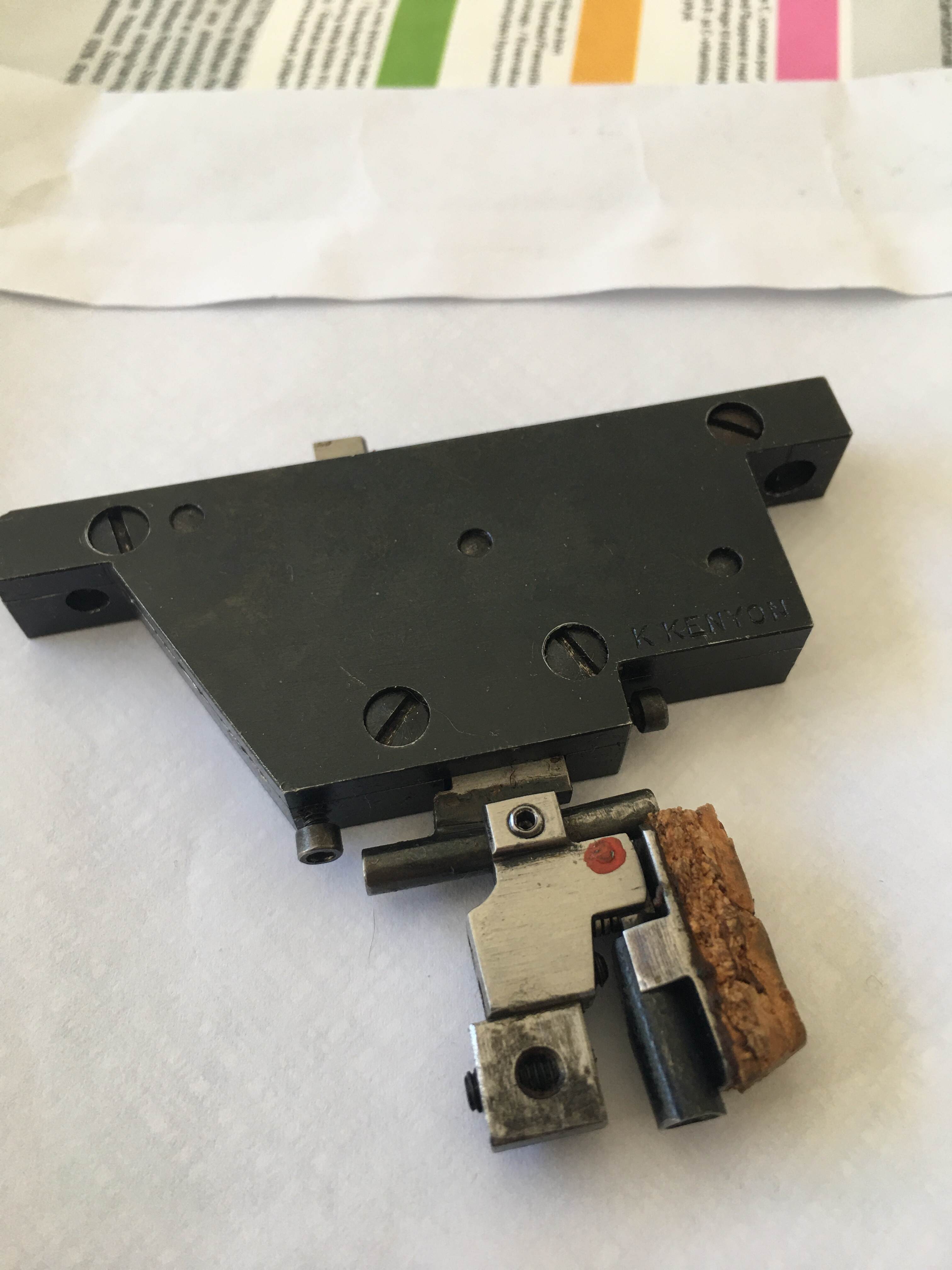

I have two Kenyon triggers: the one above is for the 1800-1900 series and the other one below is for the 1400 series:
As you can see, yours is obviously intended to be used on a 1900 serie.

When I moved to the OTC in 1985 and started training full time, it quickly became obvious to me that I needed a different trigger to fit my needs. I got a trigger from Karl, but also wished for a two-stage, which I don't think he made back then. Paul Ha was a club member and had access to a very nice machine shop at work. We worked together and came up with a very fancy version of the one in the OP's post. It actually had 2 SMALL ball bearings for the trigger shoe to pivot smoothly. The upper screw behind it worked on a spring to adjust first stage weight. The lower screw adjusted the length of the first stage and provided a hard stop to shift to second stage (the Kenyon trigger). The "external" first stage was almost completely independent of second stage and gave me the best of both.
I used that trigger to win an Olympic medal in 1992, set several world records, and win numerous other ISSF medals, quota places, etc.
THANK YOU KARL AND PAUL!
Once we had the first stage done, I shared the design with Karl. The ball bearings were over the top, but he incorporated most of the rest of the design into his first stage as an option on later triggers.
FYI, he made triggers for other brands too. The mounting holes and sear location will determine which gun it works for.

Paul, thank you for the information, so I know that this trigger fits an Anschutz 19 series...
