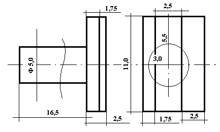

Re: question about AV-46m (IZH-46m)
It seems to me that the reason is to maintain the correct form of '17' part. Over time, its edges wear out, which causes the bolt to drop
- 3342520.jpg (20.32 KiB) Viewed 10256 times
