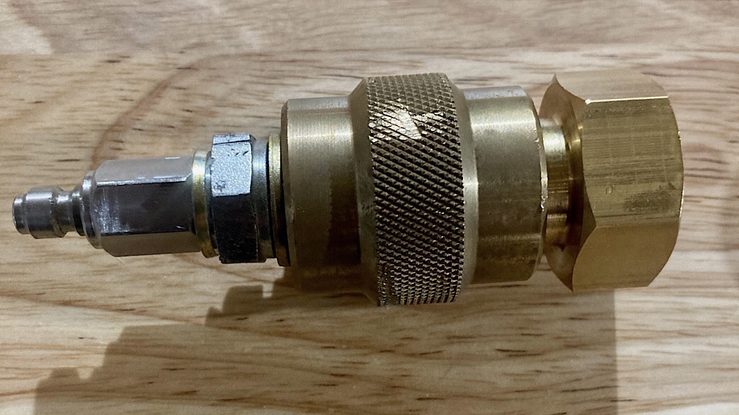

No. That is the "quick disconnect- QD" part of the device. Your FWB fill adapter screws into the DIN adapter. The QD part connects the DIN adapter to your pump. I will attach a photo of one, with a FWB fill adapter connected.
In the photo the QD is on the left, the DIN adapter in the middle, and the FWB fill adapter on the right.

Ok. I'll call CC in the am. Thanks again for the advice and the photo.
