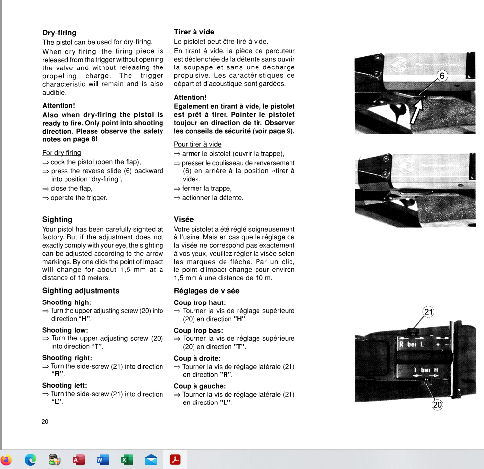

Maybe this helps.

Th. wrote: Fri Dec 30, 2022 10:49 am Maybe this helps.
I have the Manual, but thank you very much
