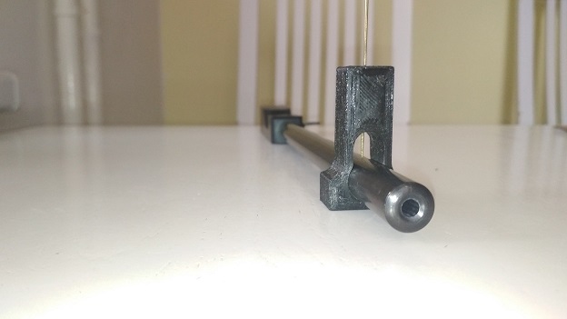

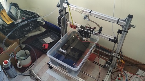

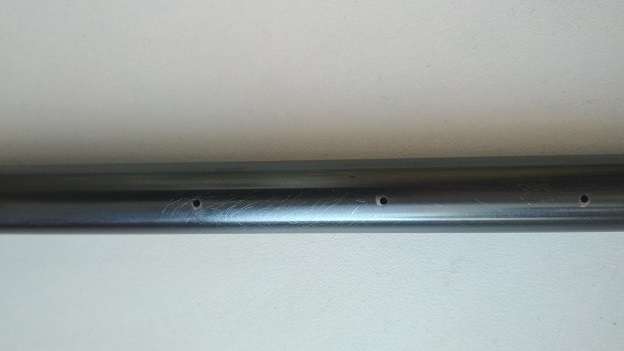

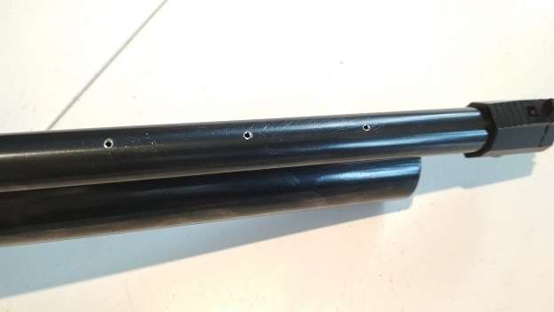

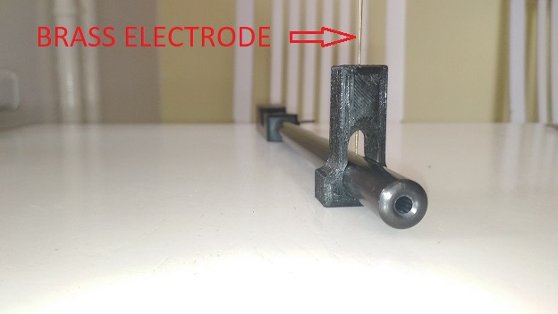

Hi,
there is a modification of the FWB Mod 2 air pistol barrel - vent holes have been drilled using home made EDM drilling machine.

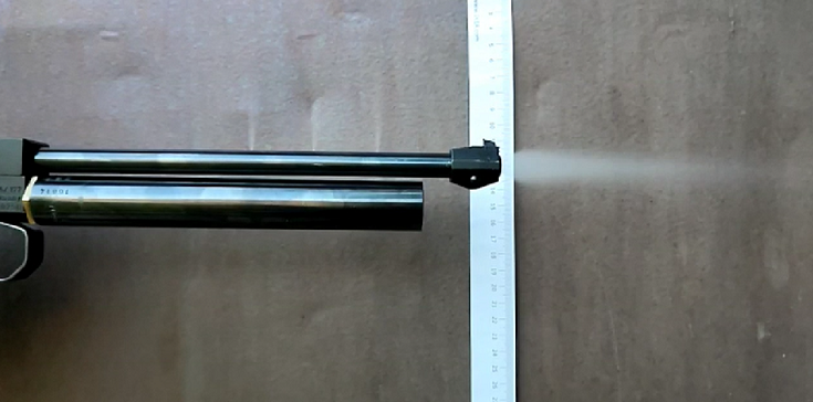

Re: FWB Mod 2 barrel vent holes
Nice work! What do want to achieve with this?
andretti
Posts: 4
Joined: Tue Dec 13, 2022 5:18 am
Post by andretti »
reduce muzzle flip.

How do you eliminate burrs inside the barrel?
andretti
Posts: 4
Post by andretti »
EDM drilling do not leave almost any burrs (why I have chosen this method), but anyway, I have polished the bore.

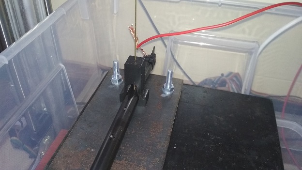

I presume a carbon EDM?
andretti
Posts: 4
Post by andretti »
As you can see in the photo, I have used a brass electrode.
