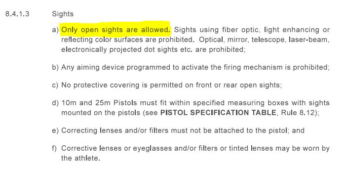

I use bright orange chalk to help my students focus on the front sight, and I've asked in the past, and the collected wisdom is that it's OK. You are not allowed to used light collecting optical fibers in the front sight. The gemstones might be considered similar.
Here's the wording from the ISSF Rules:
"Sights using fiber optic, light enhancing or reflecting color surfaces are prohibited. Optical, mirror, telescope, laser-beam, electronically projected dot sights etc., are prohibited. "
It sounds like the gemstones could easily be considered "reflecting color surfaces".

toddinjax,
I agree with Gwhite. I don't think it is in the spirit of the rule.
dulcmr-man,
A font sight with a small tunnel/hole is a diopter, not an open sight. Again, I don't think it is in the spirit of the rule.
And here is the full rule, as it is on the ISSF site, so you can make your own mind.

Thank you gentlemen. Light reflecting surface it is, I'll take it off right now.
