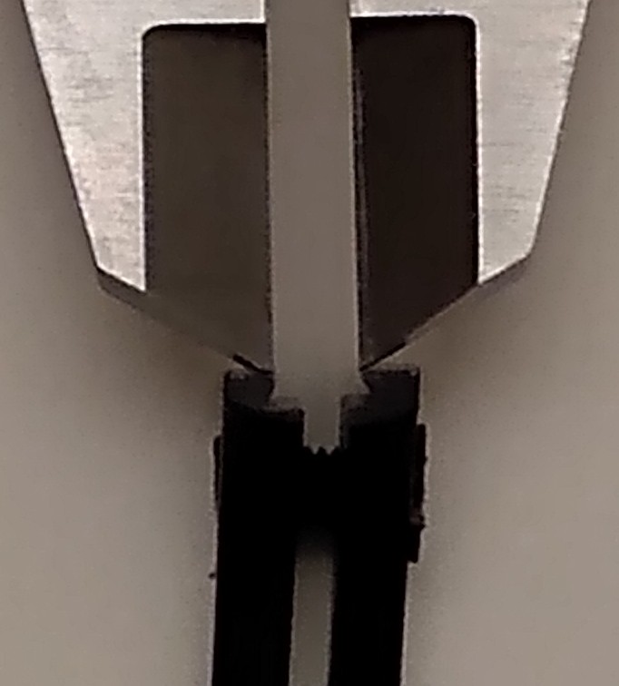

I need some help from someone with an Izh-46M and a set of calipers. Would you please measure the dimensions of the track that the trigger slides on? I need to know the width and height of the track.

I have both items. I can tell you the width is .135". The height is not possible for me to measure, nor the angle. Sorry, it sits too low in the recess to measure.

Shot in the dark: is it possible to slide the loosened trigger blade off the track and measure the opening in the top of the blade?

Track is not circular.
It is triangular with the top cut flat.
seamaster
Posts: 644
Re: Need Izh-46M Trigger Info
Post by seamaster »
Top width is 2.5mm on my caliper.
Bottom width is 4mm.
Bottom to top is about 1mm.
Those are measure of trigger triangular track slot

I did as Bobgee mentioned.
I get .115 inches at top, .145 inches at bottom.
Here is my caliper opened to .115 for scale.
