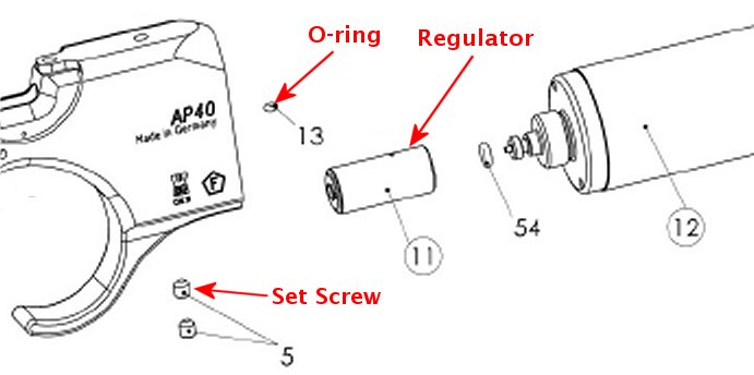

I've been studying the diagrams, and it may be that the regulator assemblies are OK. At least in the AP40, they are held into the frame with a set screw that mates with a dimple on the bottom. There is a small hole in the middle of the top that must be the low pressure port. I couldn't figure out how that would seal to the frame, but there is a very small O-ring that appears to go on top. If the regulator piston seal isn't blown it may be that the tiny O-ring is the culprit. It may even be that the set screw that holds the regulator in place has worked loose.
