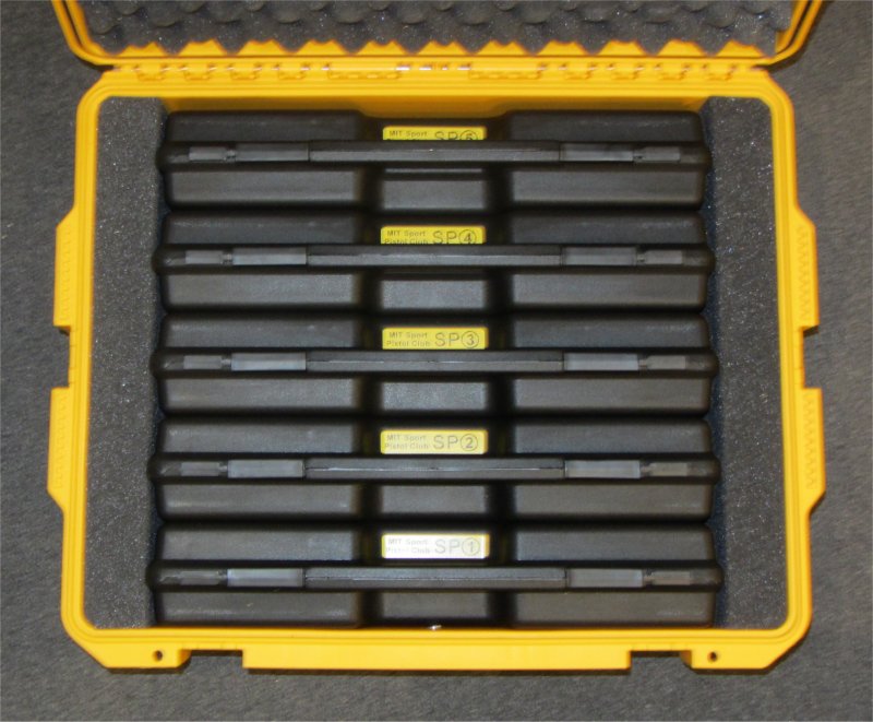

Most of the shooters I know who travel a lot use Pelican cases, or clones. The team I help coach uses Pelicans, and they are very sturdy (but expensive). The ones with a pull-up handle & wheels are easy to manage. There are quite a few sizes, depending on how much gear you want to carry.
For team travel, we have several Pelican iM2720 Storm Trak cases. Each one can hold 5 Negrini pistols boxes that all the pistol manufacturers use (Steyr, Pardini, MatchGuns, Morini, etc.). We used to pack 8 pistols in a larger case, but many airlines limit you to 5 pistols per case now. Five Negrini boxes fit perfectly with a bit of foam on the ends:
