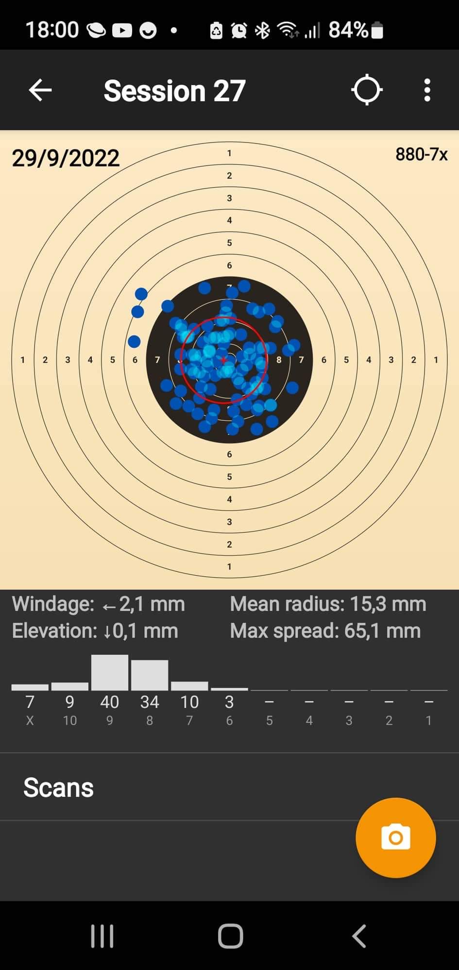

ImageA very recognised athlete in the country i live got me sceptical… its been 3-4 months im practising and in a conversation we had he told me that there is no need to follow through at this point which is totally opposite on what my trainer has told me…
But his arguments where strong….
Are you doing everything else right so you know your follow through is right too?
Do you know how to stand properly, how to raise your arm properly, how to pull the trigger properly…. So everything is ready to start training your eye to “follow through….” And create muscle memory on…..what? All the wrong things you are doing?
So he got me very sceptical…. I think he is right….
What do you guys think?
Doesnt he have a point when he says that you need to train everything else in a certain level and THEN start to train the following through procedure?
I would like to see what you guys think of that…thanks in advance….
This is my current level btw…
Th.

If you ever want to shoot sustained fire (like in standard pistol), you need to avoid relaxing as soon as the shot breaks. That muscle memory will be hard to break. We start students out with air pistol, but they are all expected to advance to shooting Standard & Sport. The recoil of an air pistol is pretty small, but you want to take at least as much time as is required to realign your sights as if you are going to take another shot.
The shots off to the left (assuming you are right handed) are most likely anticipating the shot and applying finger tip pressure.
