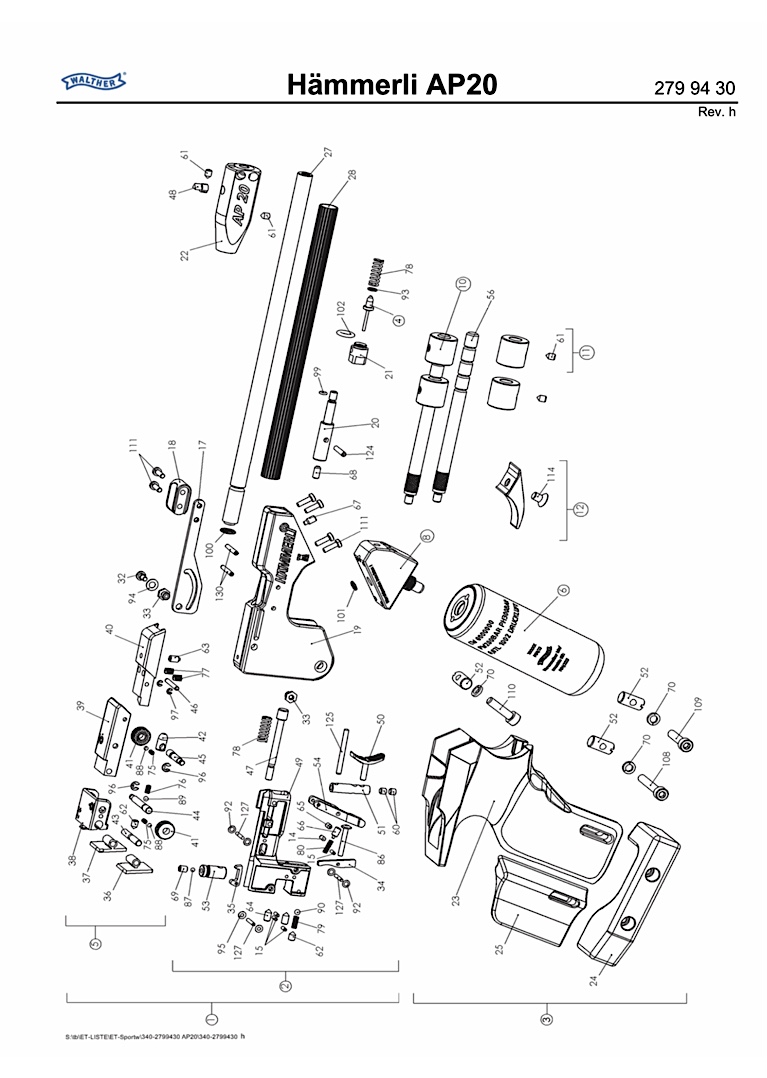

The college team I help coach has twenty six AP20's we bought several years ago. We haven't had any serious issues with them until today. A student removed the cylinder to check the pressure, and when she put a new cylinder on, there was a fairly loud hissing sound, and a definite breeze coming from inside the trigger guard. I haven't had a chance to study the parts diagram yet, but I'm guessing the regulator blew a seal.
Does anyone have any experience with this particular failure? I can send it back to Walther USA for repair, but I have no idea how good, expensive or fast their service is. I have a very complete spare parts kit, and I could also try to fix it myself. Unless the repair is pretty trivial, I'm leaning towards devoting my time to repair work I can't easily farm out.

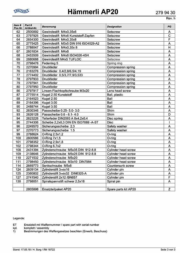

We have not had this problem, yet. Perhaps replace o-ring 101, first? (See attached.) If you come up with a solution, please be sure to post it.

That's an excellent idea! I converted them all to have the tank horizontal when we first got them, and it's possible some dirt got in there, or the O-ring got damaged in the process. The breeze I feel is in about the right location if that is blown.
The parts list has it as a 2.9 x 1.8 mm, which is not a standard size. We have an AP20 spare parts kit, and the kit includes at least one. The parts list for that has a bit more info. It's described as PU (Polyurethane, presumably), and "93Shore", which is also harder than most regular O-rings. Definitely a non-standard part. The shelf life of polyurethane O-rings in nominally only 5 years, and the pistols are approaching that, so I suppose it may have just given out.

I check the spare parts kit, and we have two spare #101 O-rings AND a complete regulator assembly. I'll try the O-ring first, and if that doesn't work, I'll install the spare regulator. If the regulator has gone bad, I can send that off for repair.

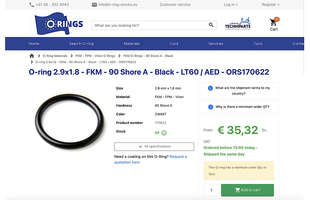

The FKM o-ring, in this particular size, exists. I could not find it in the US. I would not want to order it at the prices listed....shipped from the, EU, though.

m1963 wrote: Wed Sep 28, 2022 11:59 am The FKM o-ring, in this particular size, exists. I could not find it in the US. I would not want to order it at the prices listed....shipped from the, EU, though.
Wow! 35 Euros for ONE tiny O-ring? Ouch...
I'm sure Walther will want $5 to $10 for factory replacements, which suddenly seems like a bargain.

"FKM" aka kalrez orings are made of a special high temp, chemical resistant material. Crazy expensive. Totally unnecessary for this application

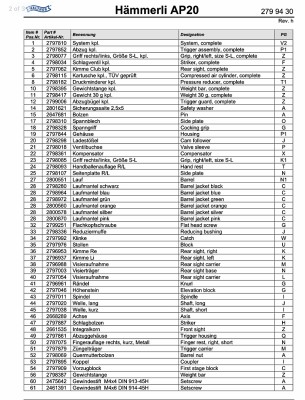

I had a chance to sneak into the shop during our match today and investigate. The leak is from the inside of the regulator (Diagram Item 8: "Pressure Reducer", # 2798182), not the seal between the regulator and the frame. However, it's not a total loss. O-rings will seal better & better as the pressure increases IF they seal well at low pressure. In this case, I think there is a tiny bit of dirt or a scratch inside that makes it not quite seal well at low pressure. If you screw the cylinder on SLOWLY and stop as soon as it starts hissing, it will bleed out the entire cylinder. However, if you screw the cylinder on quickly, or even give it a quick twist when it starts leaking, there is a distinct POP from inside as the seal seats, and then you are fine.
Unfortunately, the "Pressure Reducer" appears not to be designed to be serviced, at least not easily. It is only shown as a complete assembly in the parts diagram, with no internal parts listed.
