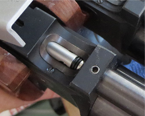

The only seal that was not replaced in that article is the breech seal.
Here's a picture of the breech seal, using two O-rings instead of the original factory part. Those tend to be old stock prone to failure.
The alternative shown uses two Metric 1.2x3.5 BN70 seals.
Jim
Great resource!
Jim

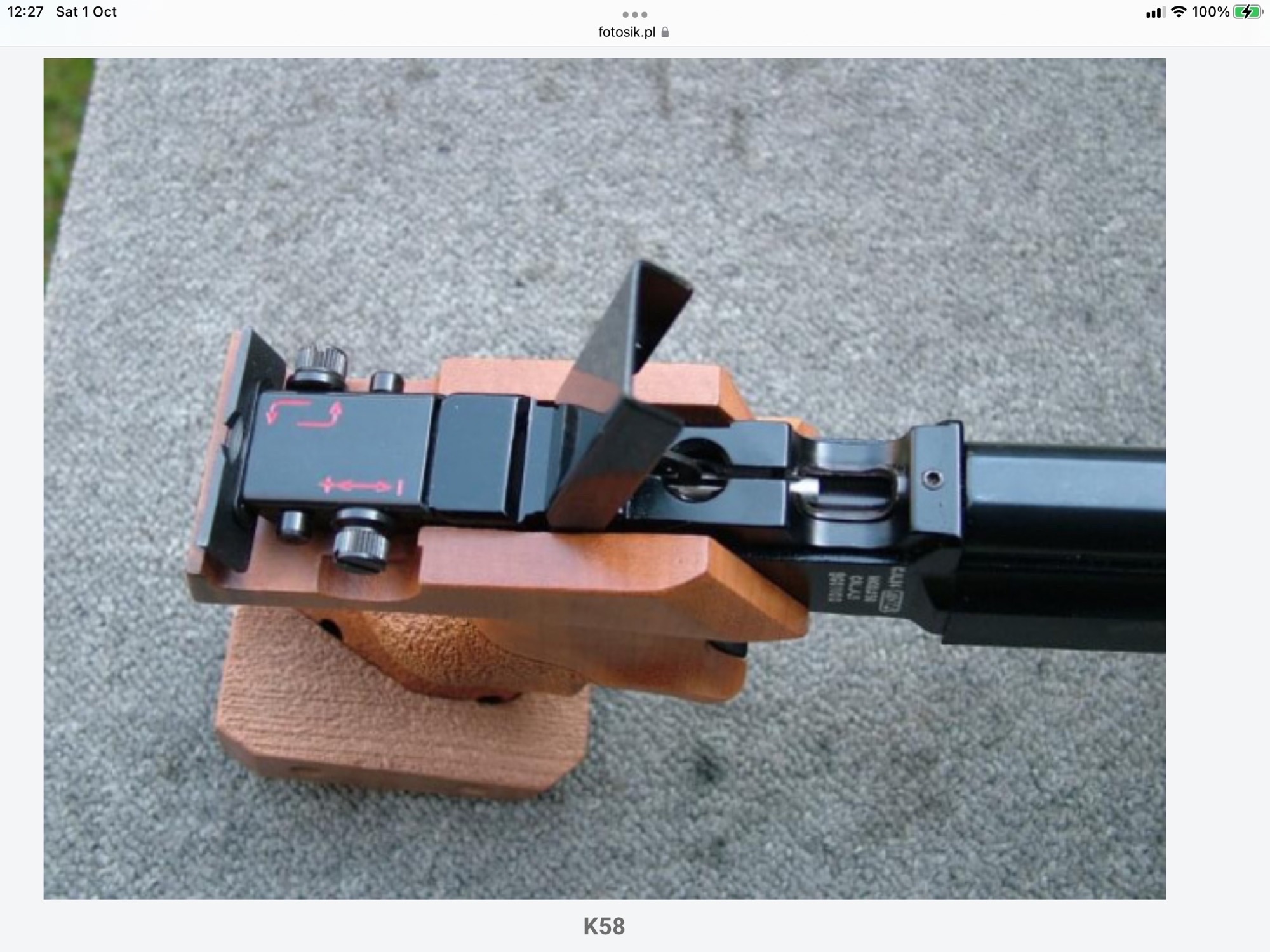

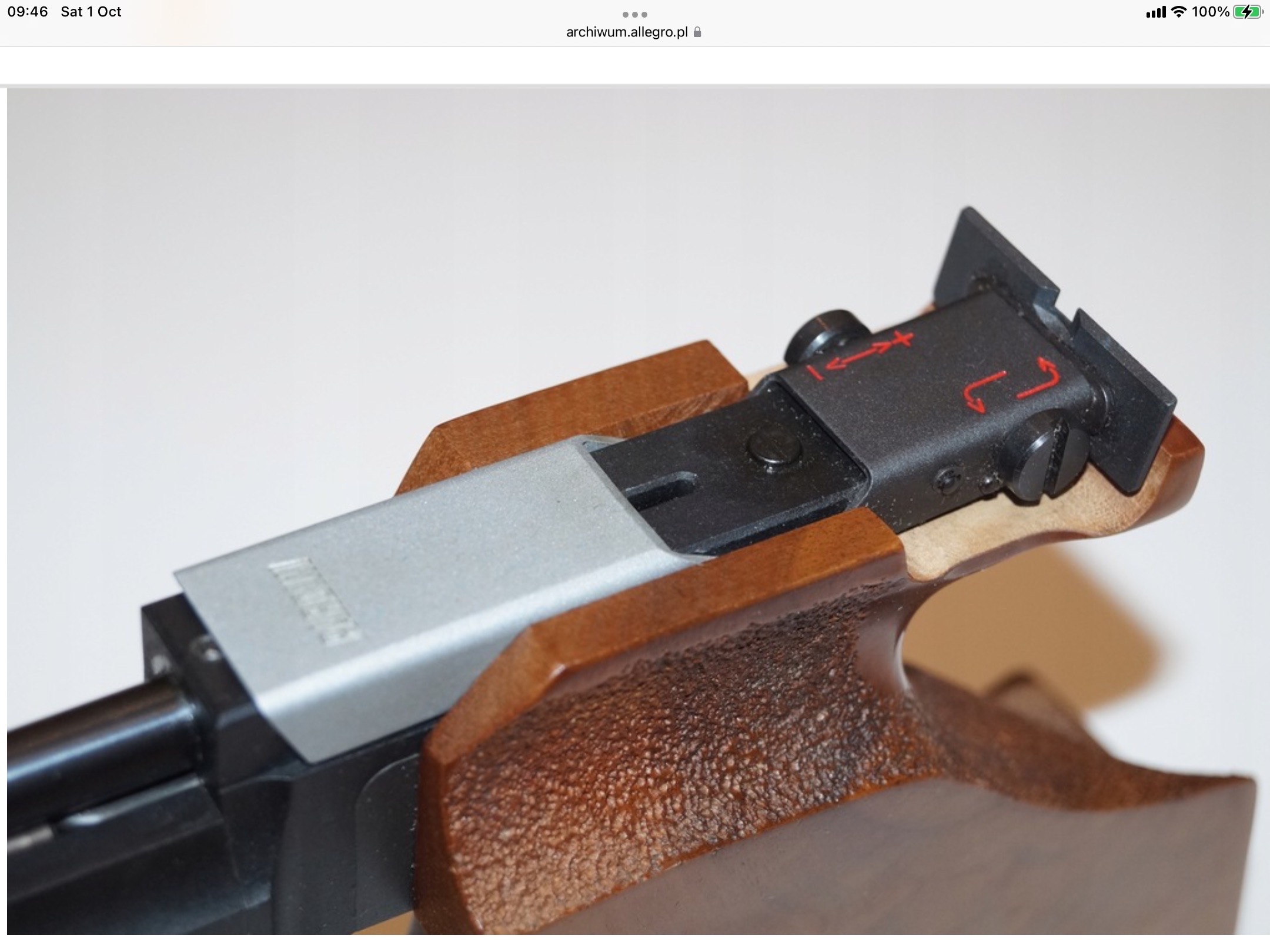

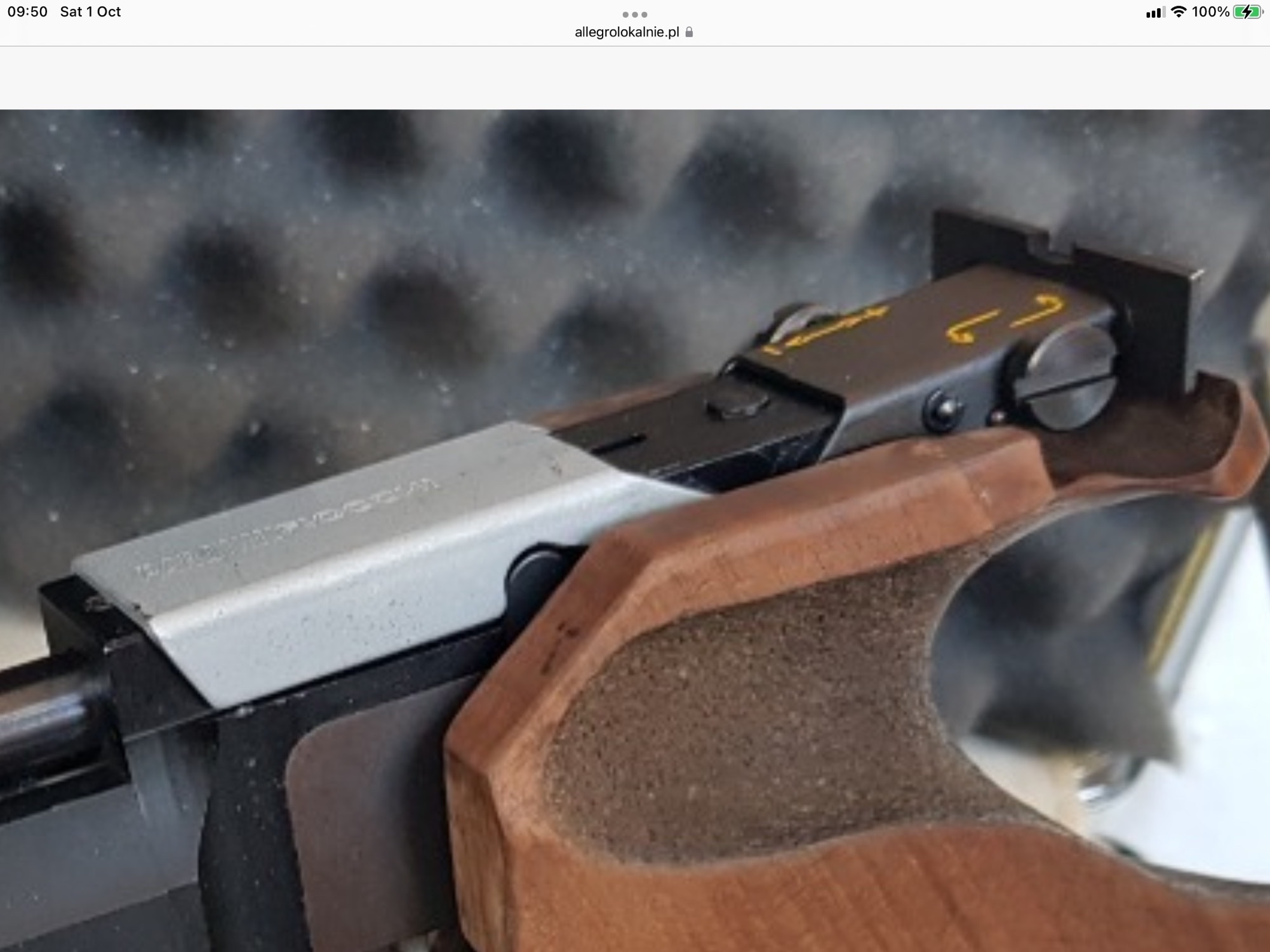

Does anyone know how many K58s were made and over what years they were manufactured?
From the images available on the internet there seems to be at least 3 different versions of the gun through its life.
Early ones seem to have yellow markings on the rear sight and later ones had red markings. There’s also a pic with a version with a black breech cover, different rear sight and white markings on the side of the gun.

Old thread i know but not much info on these so i just wanted to add that Pardini just confirmed my K58 was made May 2007, (i thought they only made them from mid 80's to mid 90's).Hijacked wrote: ↑Fri Sep 30, 2022 6:35 pm Does anyone know how many K58s were made and over what years they were manufactured?
It has the black breech cover, red markings on rear sight, white markings on side of the action and the trigger shoe is like the current Pardini triggers.
