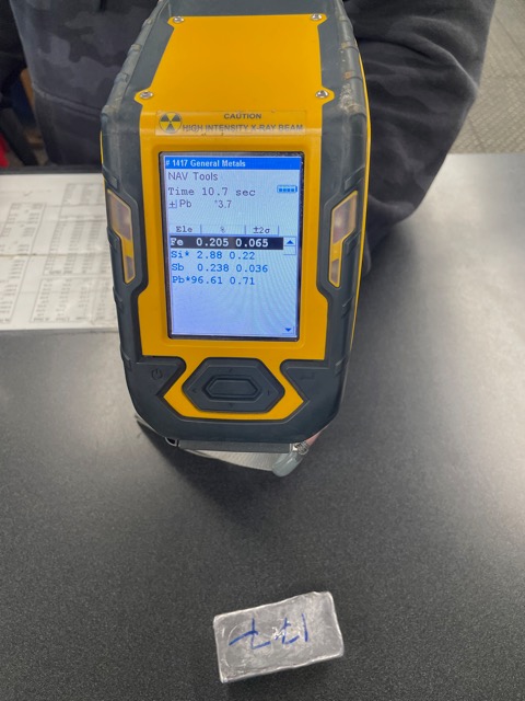

If you are really interested, take your ingots to the local metal scrapyard that possess an X-ray analyzer.
Bring donuts or cash to "grease the skids".
I had a friend take a box of my mystery metal to the local yard and they charged him $20.00 USD for five tests.

fc60 wrote: Tue Aug 02, 2022 1:42 pm Greetings,
Here is what Dave is referring to...
The Silicon and Iron readings are from the filing/sanding of the ingot to get a better reading. (I have to remember to wipe it down better, before I take it in.)
The metal is what I gathered from my pellet trap. I shoot mostly RWS Basic or Hobby (shameless plug for Rover) and maybe some odds and ends given by friends to try in my 747 or K58.
So, mostly lead and some antimony
