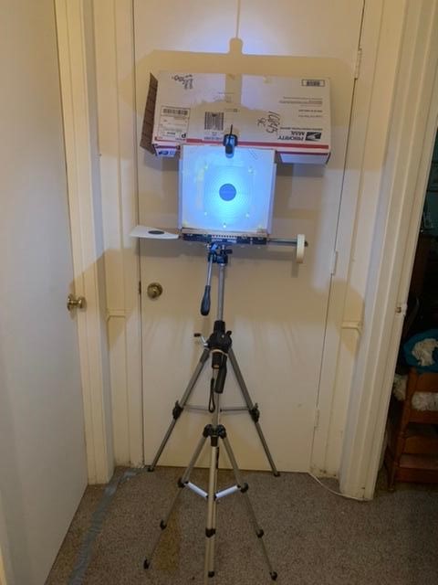

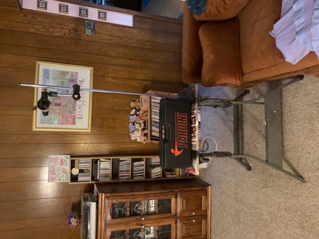

Pitt Willett wrote: Sun Jul 31, 2022 1:31 pm but an alternative is to just set up a pellet trap and shoot paper targets. This doesn't necessarily mean low tech though. My system consists of a pellet trap, projector tripod on wheels to get the trap at correct height, clip on LED light to shine on the target, and a Wyze camera/app also on a second tripod in front of the target. Using that I can spot the shots on my phone real time without having a spotting scope get in the way. Kinda off topic here but being new AP shooter was wondering if you considered a simpler approach to start out with.
Works fine for us peons.
BTW the blue color is just camera color error. The light is actually white.

It’s not a projected image it’s an actual target held on with push pens on a box filled with rags. The lighting are 2 high intensity LEDs flashlight type illuminations.

I'm glad you sent pics Xman that looks almost identical to my set up. I'll also add that one is able to do some shooting drills using paper that aren't practical with ETS - such as shooting at a vertical line instead of round bull. My coach recommended that as most of my points lost seem due more to X direction errors than Y. There's also quite a bit of consumables for ETS such as ribbon rolls and target faces. Not that I'm against ETS. I think they are awesome but maybe not everyone is aware of the consumable costs involved.
