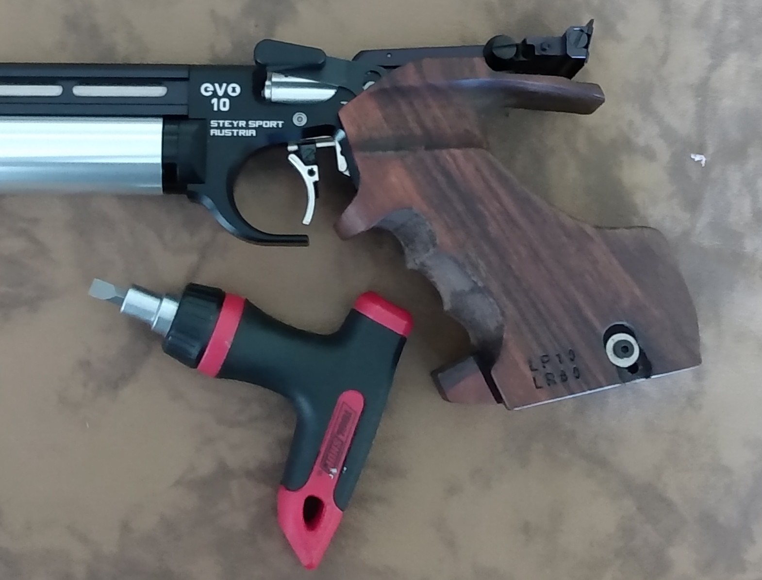

I'm sure I'm not the only one with this issue in that my trigger shoe can be knocked off center of the little rail/post that it fits over and screws onto. Shooting causes no problem but if inadvertently bumped the blade can be knocked off axis. I thought about putting a drop of clear nail polish on the rail along with a drop inside the mounting hole(?). is there a common fix for this little annoyance?

A screwdriver with a larger radius on the handle. The supplied version is too skinny and slippery.

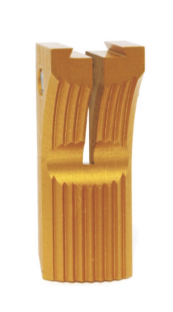

The Centra trigger blade shown at the bottom of this post, and on this website, is for a Morini. (The Centra blades appear to be made by Lottes, but are marked Centra):
https://shop.mec-shot.com/putter.html
Another option to purchase the Lottes/Centra trigger blade, of any flavor, is Buinger-
https://buinger.com/Centra-Putter_1
At the end of the day, the only fool-proof solution is a switch to a Morini style trigger blade mount (a Morini air pistol)...or finding someone who can machine a trigger bar to fit your needs,...
