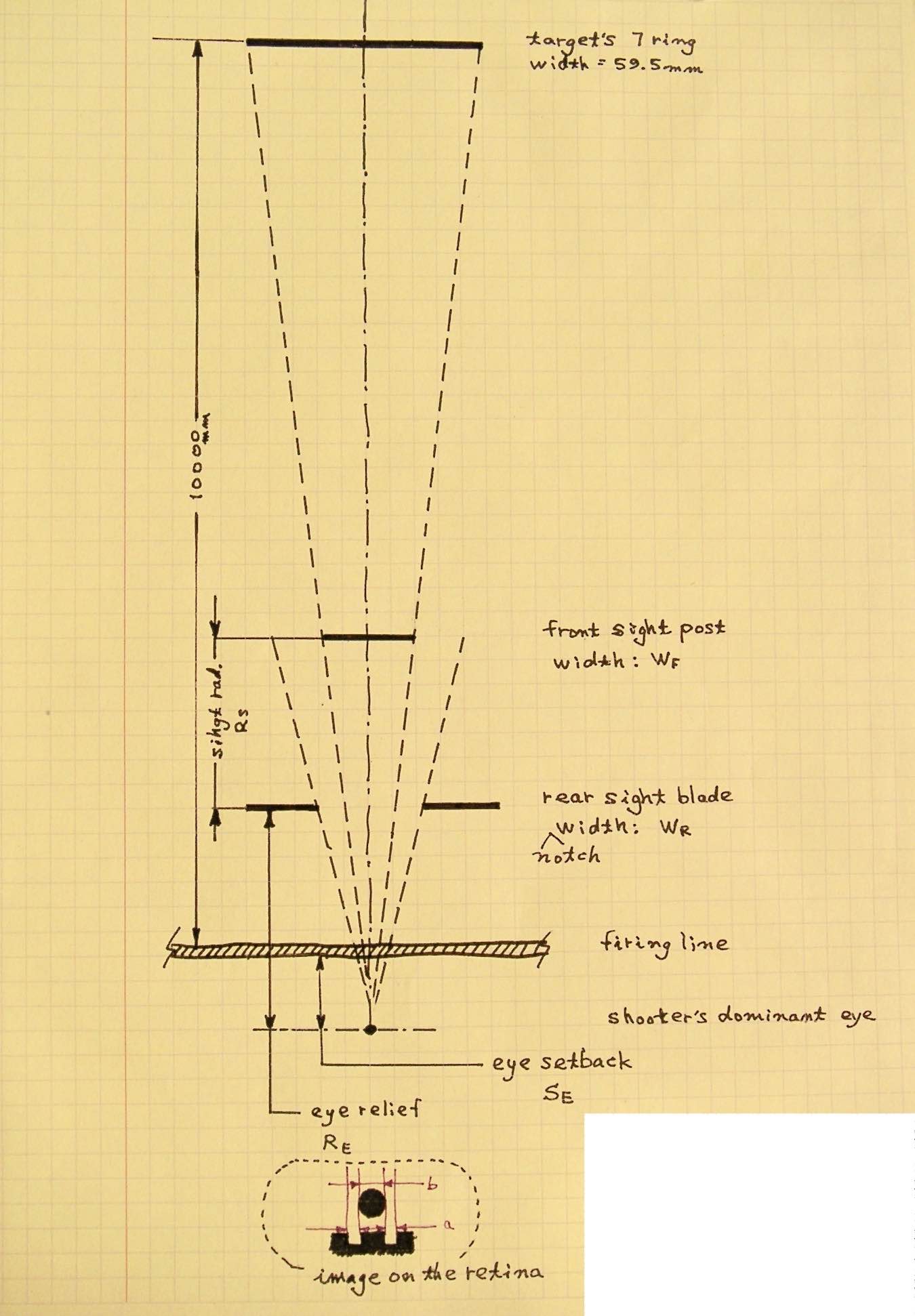

Re: Front post vs rear notch size?
In order to calculate the front sight post width and the rear sight notch width which bring the sight picture you would like to have, you need to know not only the sight radius but also distances between your eye and the rear sight("eye relief" hereinafter) and distance between the firing line and your eye("eye setback" hereinafter).toddinjax wrote: ↑Wed Jan 19, 2022 3:45 pm My 60 year old eyes would love to have a "1 2 1" sight picture because now I have too slim gaps of light on either side of my front post. I currently am not using the widest (4mm) post in my possession as it allows barely any light. I have 2 of the exact same rear sight blades and my machinist brother is going to widen the gaps for me. I have searched several other threads looking for the correct ration to achieve a better sight picture but have found only graphic illustrations of beautiful sight pictures. Can somebody tell me for a 4mm wide front post, just what size gap should be in the rear blade to get something approaching a 1 2 1 sight picture? If it matters the sight radius my a 46m is 36.4m
In calculating the front and the rear sight widths, imagine a picture projected on your eye's retina, and we can write equations for these width. Please take a look at the schematics below. In order that the projected width of the 7 ring and the front sight post on the retina is equal,
59.5 / ( 10000 + SE) = WF / ( RS + RE ) ... eq. 0
where
SE is eye setback.
WF is front post width
RS is Sight Radius
RE is eye relief
solving the eq. 0 for WF,
WF = 59.5 / (10000 + SE ) * ( RS + RE ) ... eq. 0a
In order that ratio of the the projected widths of the front post and the rear notch is Ratio,
WF / ( RS + RE ) * Ratio = WR / RE .. eq. 1
solving the eq. 1 for WR,
WR = WF / ( RS + RE ) * Ratio * RE .. eq. 1a
Equations 0a and 1a can be written in MATLAB function as follows.
% an example of Walther LP500 with M-size grip held by 5'10"-tall Japanese
% male in in-line stance
SE = 200; %eye setback
RS = 385; %sight radius, adjustable between -38mm and +2mm
RE = 595; %eye releaf
Ratio = 1.5; %notch width by post width ratio projected on the retina
WF = ap_Front_post_Width( SE, RS, RE);
WR = ap_Rear_notch_Width( RS, RE, WF, Ratio);
function frontSightPostWidth = ap_Front_post_Width( SE, RS, RE)
frontSightPostWidth = 59.5 / (10000 + SE ) * ( RS + RE );
end
function rearSightNotchWidth = ap_Rear_notch_Width( RS, RE, WF, Ratio )
rearSightNotchWidth = ( WF / ( RS + RE ) ) * Ratio * RE;
end
following are calculation results for my particular case.
WF = 5.716666666666667
WR = 5.206250000000001
In reality, WF and WR in my real case are little bit smaller than the calculation results and are 5.4mm and 5.1mm respectively. Ratio 1.5 is equivalent to 1:3:1 in toddinjax's scale. For 1:2:1, substitute 1.5 with 2.0.
toddinjax,
If you could give me your eye relief and eye setback, I would be pleased to calculate WF and WR for you and the 46M. I am 71y old, by the way.
regards.

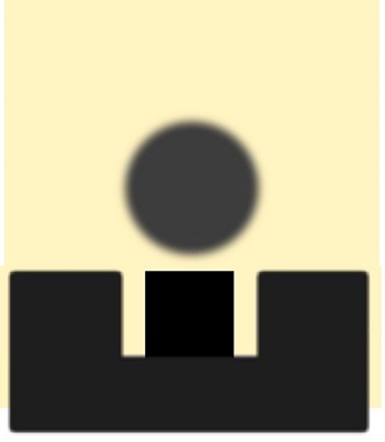

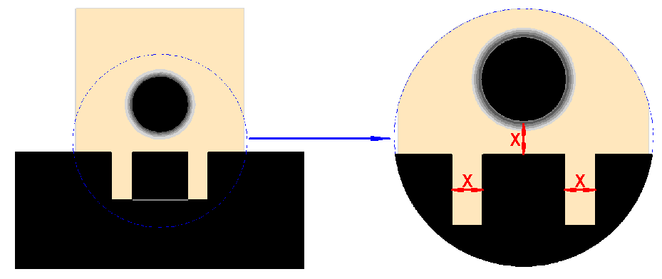

There is a problem with the calculated sight sizes.
Yes, the maths is correct but we are dealing with perceived sizes and different focal lengths and
different levels of focus.
This foresight picture is approx. 70% of perceived blurred target image and has a 2:1 ratio.
The spacing is 1/2 on each side of the foresight.
Good for precision.
Most Standard pistols will have sights from 3mm to 5mm.
On a typical pistol with 150mm sight radius the foresight will be from 3.2mm to 3.8mm, depending on arm length.
Free pistol sights can be from 3.5mm to 6mm.
A 4mm - 5mm foresight will only be used on a long barrel Freepistol usually with a sight extension.
Airpistol sights can be from 3.5mm to 6mm.
Airpistol’s at 10m will have a 3.6mm- 4.5mm foresight with rear sight width to suit your arm length, pistol
rear sight position and what glasses you use.
For Rapidfire open the rear sight out to a 3 to 1 ratio.
Good for precision.
- sight 70%.jpg (11.26 KiB) Viewed 9190 times
- Optimum Sub-Six Sight Picture.gif (8.04 KiB) Viewed 9190 times
