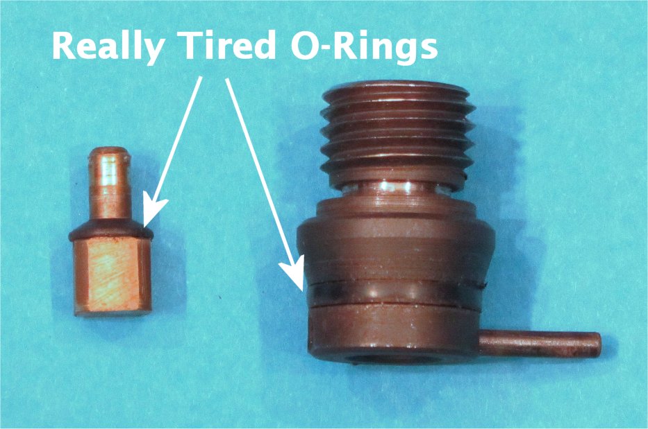

Because CO2 is a liquid, the secret to bulk fill is to park the pistol upside down for a couple minutes with fill bottle screwed on. As long as the valve in the fill adapter is work well, you should get a good fill. If you have a digital scale, you can weight the empty pistol and make a note of it. Once it's filled, weight it again to see how much CO2 you got into it.
Overtime, the O-ring in the bulk fill adapter valve can get mashed, and then it becomes difficult to get a good fill:
It's pretty easy to replace the valve O-ring. You want to use a D90 hardness O-ring to get the most life out of it.
