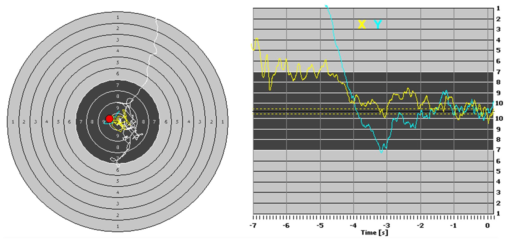

From some coaching notes I put together several years ago:
One mistake that many shooters make is waiting for their hold to fully settle before they begin their final trigger squeeze. You want the shot to break when your wobble is at its minimum. If you wait for that before starting your final squeeze, the odds are very high that the shot will occur AFTER your hold has started to deteriorate. Unless you have an unusually long period of minimum wobble, you MUST start your squeeze BEFORE the pistol is fully settled.
This takes some courage to do, but once you get used to it, you will be amazed at how good the results can be. It also takes some practice, and if you don’t get a few shots that go off too soon, you aren’t trying hard enough! If you are in good shape, the “minimum” hold may last several seconds, giving you extra margin in timing. The one caution with this approach is that it is easy to fall into the trap of “rushing” the shot off to try to catch that “minimum wobble window”. It can take a lot of careful practice & training to speed up your trigger release without getting too aggressive with the trigger.
The images below show air pistol plots from a Noptel electronic trainer. The target pictures shows the path taken to the final shot location, and the other plots show the XY aiming point as a function of time. The first image shows a well executed shot. The pistol comes down into the aiming area, "bounces" vertically once, settles, and POP. The shot breaks within a couple seconds of when the shooter first settles into the aiming area, and there is no significant deflection after the shot (good follow through). The result is a 10, with very little wasted effort.

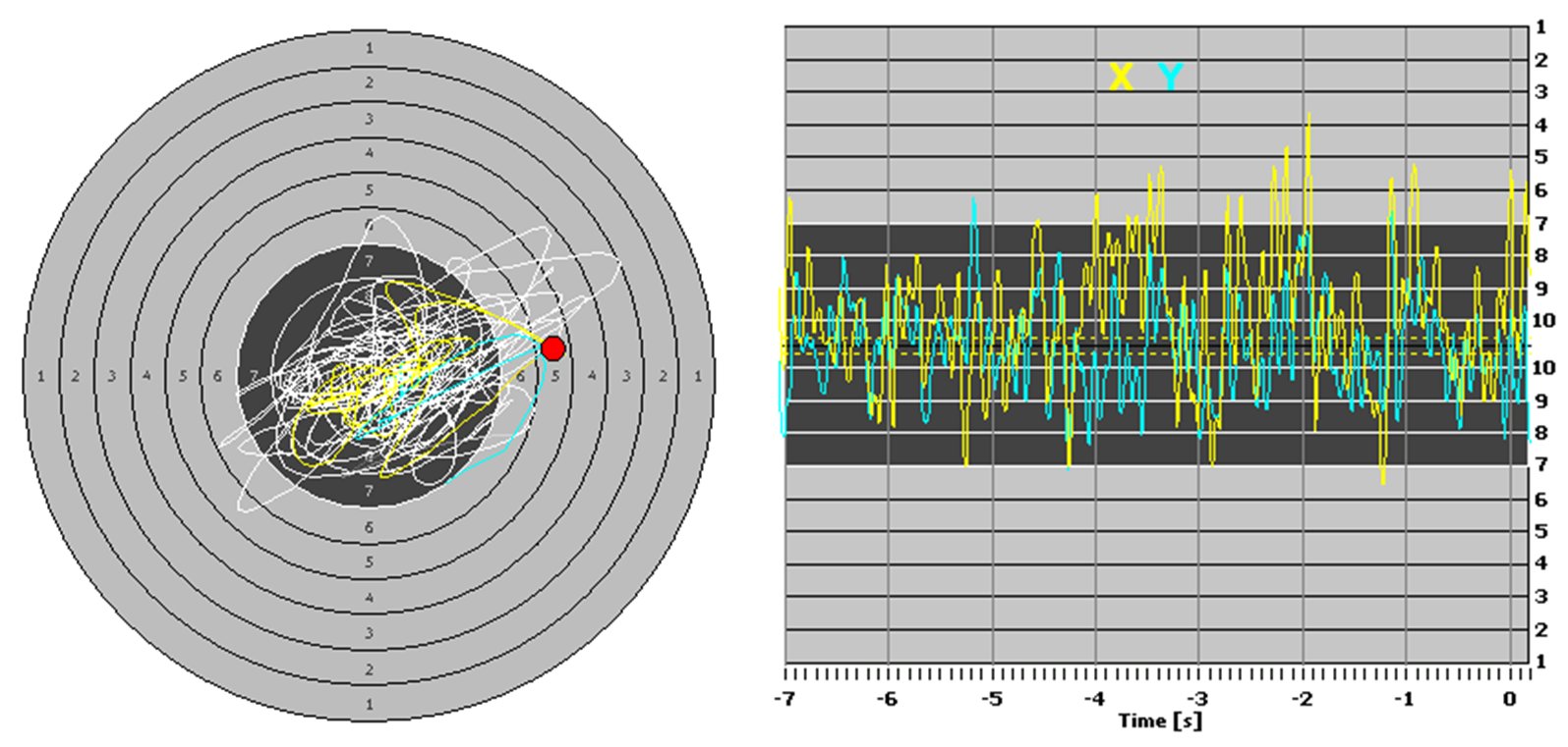

The second image shows what tends to happen when you hold too long. The downward approach occurs more than 7 seconds before the shot breaks, and is off the time scale of the XY plot. Between about -6¾ seconds and -5¼ seconds, the pistol is moderately well settled. A shot fired in that 1½ second period would be at least an 8, with a good chance of being a 9 or a 10. Instead, the shooter continues to hold as things begin to deteriorate. The pistol begins to oscillate more and more horizontally, and the shooter is eventually rewarded with a 5 and a tired arm.
Assuming the shooter settled a second or two before the XY plot starts, they took an extra five seconds to fire the bad shot. Over the course of a 60 shot match, that's a full 5 minutes of extra time spent holding the pistol up, which is a lot more wear & tear on your arm and eyes.
