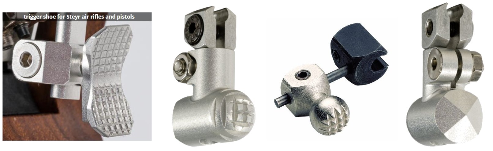

I'm almost 70 years old, and I've been having a lot of trouble with my trigger squeeze in recent years. I have a hard time feeling that I'm increasing the pressure on the trigger.
I have spent a good bit of my life messing with mechanical things, and use my trigger finger for grabbing, twisting & turning things. A while back, I had a lengthy battle with an FWB 65 breech seal that left my finger tip numb for over a week. It occurred to me that all that wear & tear may have reduced the sensitivity of my trigger finger. It definitely feels a bit "dead" compared to my other finger tips.
I'm currently shooting a Steyr, with wide flat silver trigger blade. It feels nice to just park your finger on, but I think that may be counterproductive. It spreads the force out, and I think it makes the "pressure sensitivity" problem even worse. There are a number of "sensiv" trigger blades, but I think are mostly designed for rifle shooters. There are several variations, but they have a small number of sharp points that I'm guessing would dig into the finger tip with increasing pressure, (hopefully) enhancing the feel of the increased pressure.
They vary from slightly aggressive checkering, to a single sharp point:
The second & third one are actually the same trigger, but it's reversible: https://shop.ahg-anschuetz.de/en/match- ... oint?c=112 I'd try that one, but I am concerned that it may limit how far to the rear you can place the blade. My guess is that the more aggressive ones are meant for rifle, where the trigger force will be a lot lower. I don't want to tenderize my finger tip too badly over the course of a match...
I know a few people have asked about these in the past, but I'd like to hear if anyone has any first hand experience with them. I may 3D print a few options & see if it makes any difference. I made an extra short trigger blade for my wife's MG2 .22, and it fits the Steyr down rod, so I have a good starting point.

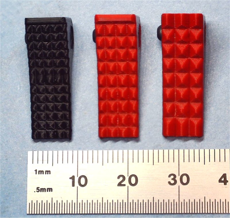

I've got three triggers set up for 3D printing so far. The first is roughly equivalent to the Steyr factory trigger. The second has fairly fine checkering, and the 3rd is a bit coarser. I'm printing the coarse one overnight, and should have photos of the results sometime Wednesday. The fine checkering doesn't feel that different from the smooth ribs of the factory trigger. I'm hoping the coarser checkering will produce a much more pronounced increase in sensitivity. Whether I will want to go coarser still may wait until I do some test firing.

I can design & print pretty much anything I can imagine. The hard part is finding the time to do the CAD design and fit it into the steady stream of print jobs. The resolution of the printer does introduce some limitations to fine details, like how sharp I can make the checkering on the trigger faces. Here are the three triggers I made yesterday:
The layers from the printing process make them a bit hard to see, but the two on the right have pyramids of different sizes on the front.

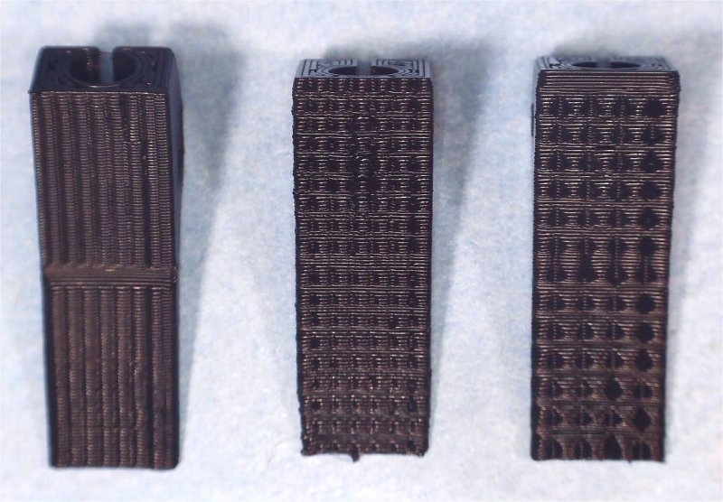

Here are the two "sensive" designs:

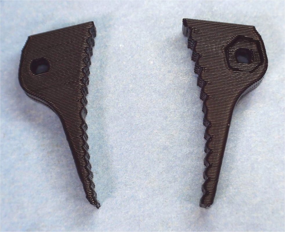

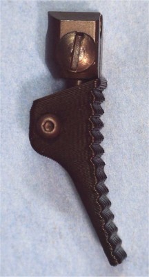

And here is the one I'm going to test for a bit, with the mounting hardware:
I can definitely feel the bumps. Whether that translates into better trigger control remains to be seen.

Gwhite wrote: Wed Nov 17, 2021 10:24 am I can design & print pretty much anything I can imagine. The hard part is finding the time to do the CAD design and fit it into the steady stream of print jobs. The resolution of the printer does introduce some limitations to fine details, like how sharp I can make the checkering on the trigger faces. Here are the three triggers I made yesterday:
I may not be able to buy points, but maybe I can print a few...
I like the one on the top left. If you go commercial, please let me know.

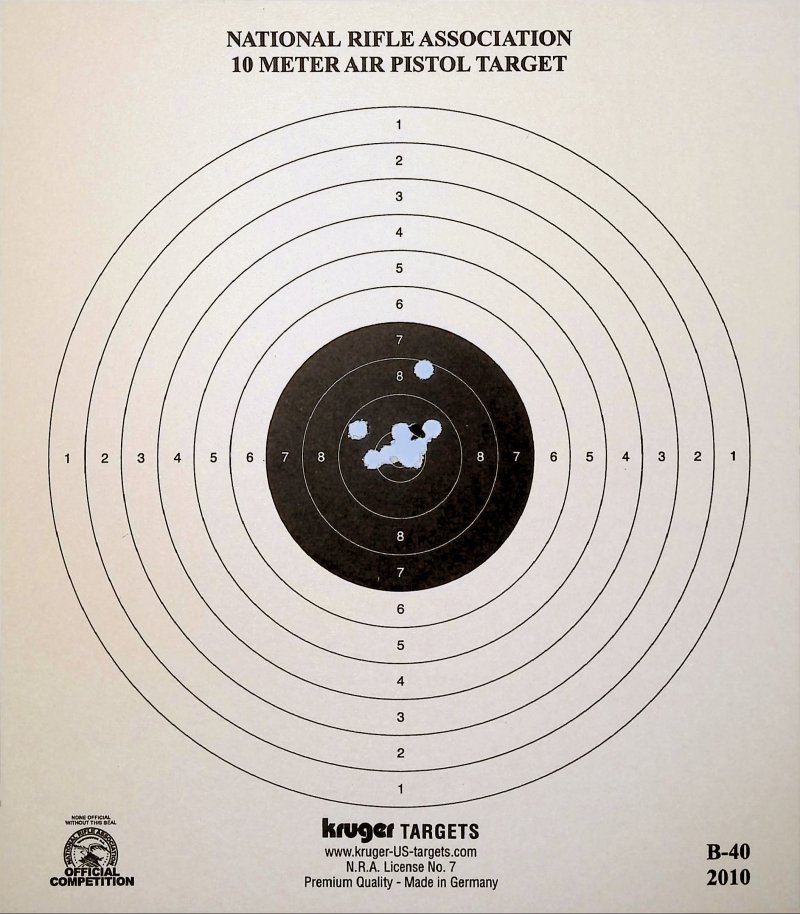

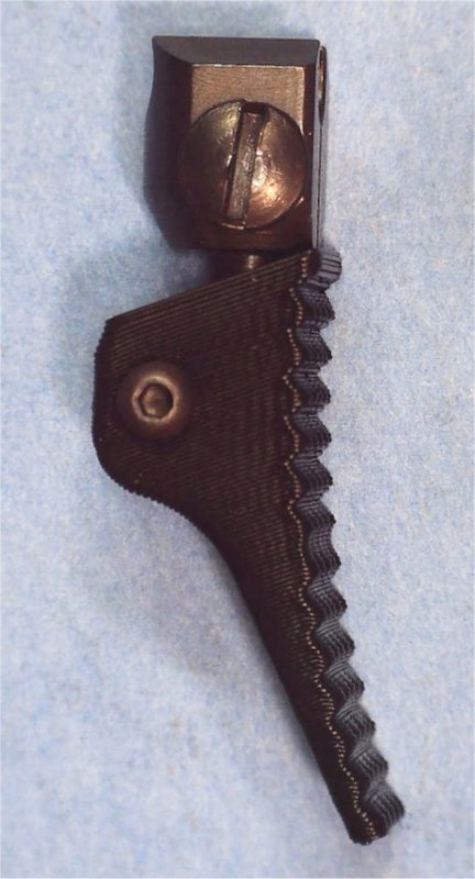

Time for an update: It's difficult to print really sharp points, but by making the "checkering" coarse enough, you can still get a "pointy" feel to the trigger. I haven't tried sharpening the points yet. I worked with three different designs:
The first one (which was the coarsest of the ones I tried initially) was still way too fine, and I couldn't really feel any difference. The middle one was a bit better, but it still didn't really enhance the feel of the trigger. I've currently got the coarsest one installed, and that definitely provides some additional feel.
I haven't had a chance to practice with it very much, but I think I will stick with this version for a while. After several days off due to holiday festivities, I finally picked up the pistol last night, and shot this right off the bat:
I'm sure there was a bit of luck involved, but I haven't shot a target like that in years. Now I just need to build my stamina back up & get my shot process ingrained using the new trigger.
I need to double check that I have one of the grooves centered for trigger weighing, but I think the latest one will do the trick, even without sharpening.
