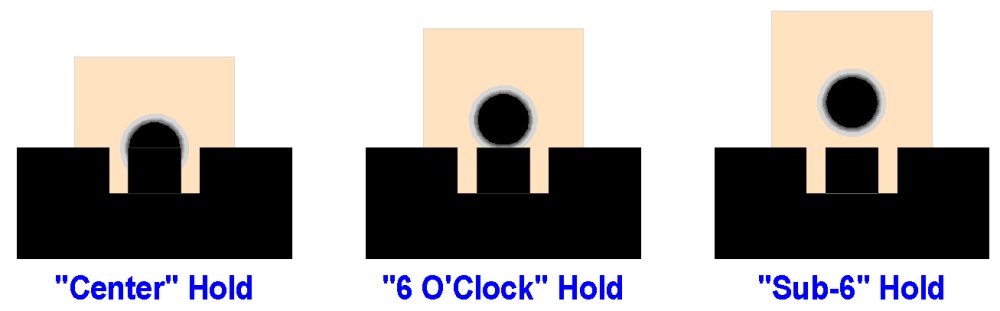

Re: Better groups on blank target
Jon Eulette wrote: Mon Sep 20, 2021 11:45 pm .. Also if you decide to shoot sub 6 hold watch for vertical stringing. It’s common. Most average shooters don’t do well with sub 6.
Jon
The vertical stringing usually occurs when the using a 6 hold or sub 6 that is too close to the black, the sight and black tend to mend giving you a vertical string.
"Would this be a sign that one perhaps should try (what I seem to remember being called) a "deep sub 6 o"clock" hold, that is with your sights down in the region of the 4-3 ring?'
When thinking about sub 6 hold do not think about 4-3 ring (lookoing at target).
Use sight picture with equal light gaps Side bars and top bar equal).
Sight Pictures.jpg (28.15 KiB) Viewed 4859 times
Posts: 3582
For a decade or two, the "sub-six" hold was the secret weapon of the collegiate team I was on, and am now helping coach. We frequently beat the various service academies (West Point, Navy, Air Force), who were all using six o'clock holds. I believe the NRA still promotes the six o'clock hold for target shooting.
I went to a coaching workshop at the US Olympic Training Center several years ago, and they mentioned the idea of the "equal gap" sight picture. The goal is to teach your brain to try to achieve the highly symmetric image as a whole, and not to think of it as three separate pieces. This helps to reduce the complexity of the problem & offloads your brain a bit.

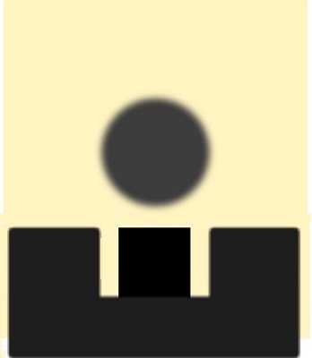

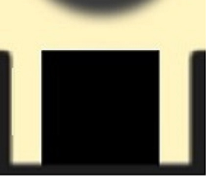

porkchop wrote: Wed Sep 22, 2021 7:40 pm " Also if you decide to shoot sub 6 hold watch for vertical stringing. It’s common. Most average shooters don’t do well with sub 6.
I will say it again, vertical stringing is usually trying to hold too close to the black.
Most average shooters have a 6 o'clock hold rather than sub-6.
Try increasing the light gaps to equal gaps.
Try this as a ideal sight picture.
Foresight 70% of apparent target black.
Foresight ratio 2/1 ie. half width light each side of foresight.
Foresight height adjusted to appear as a square.
Equal light gaps at sides and above foresight.
sight 70%.jpg (10.56 KiB) Viewed 4629 times
The secret is focusing on the square.
Posts: 747
David M wrote: Wed Sep 22, 2021 9:05 pm
There is no better diagram for shooting than the top picture of David M's post above. That's what everyone should strive for imo.
