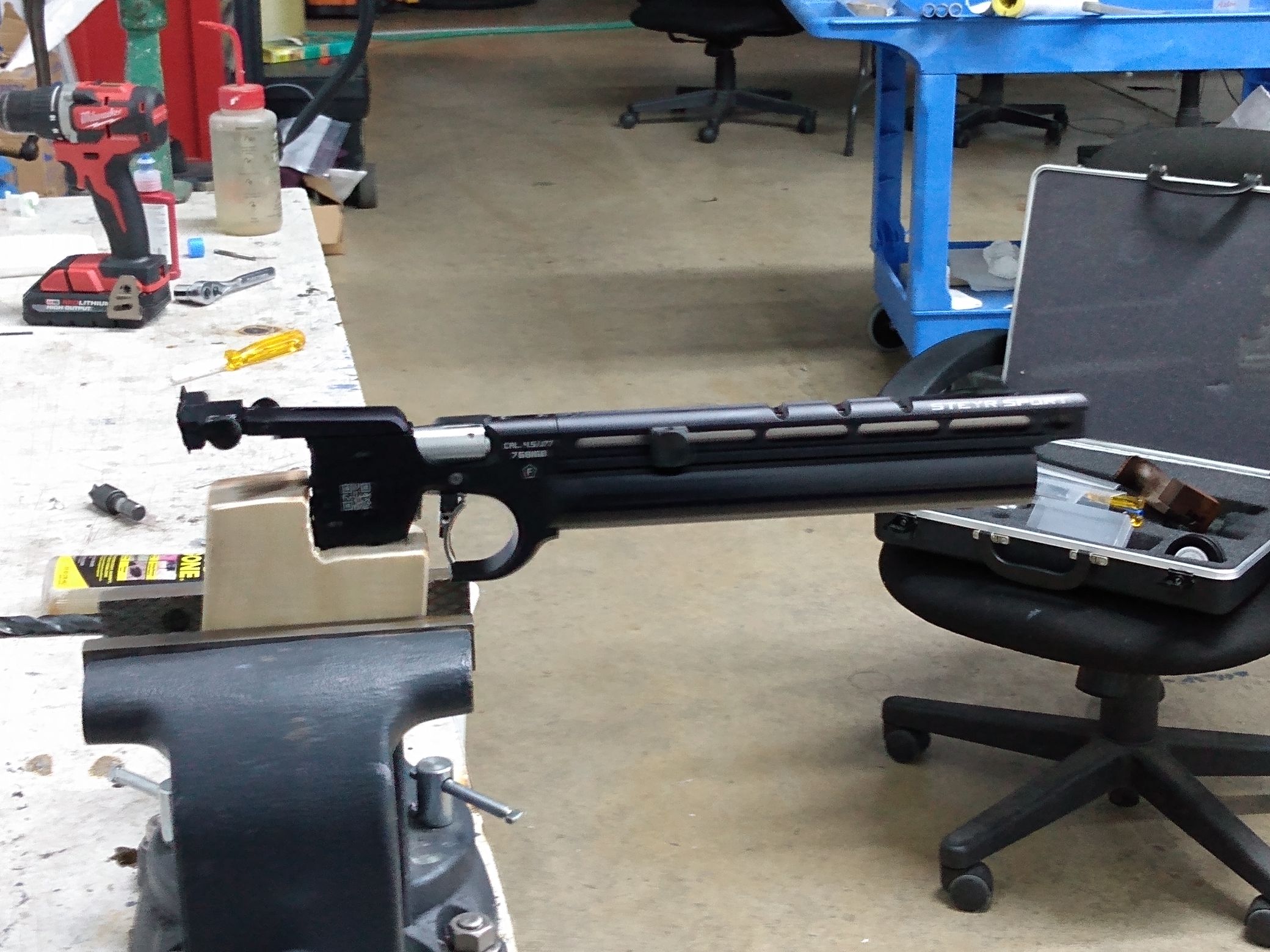

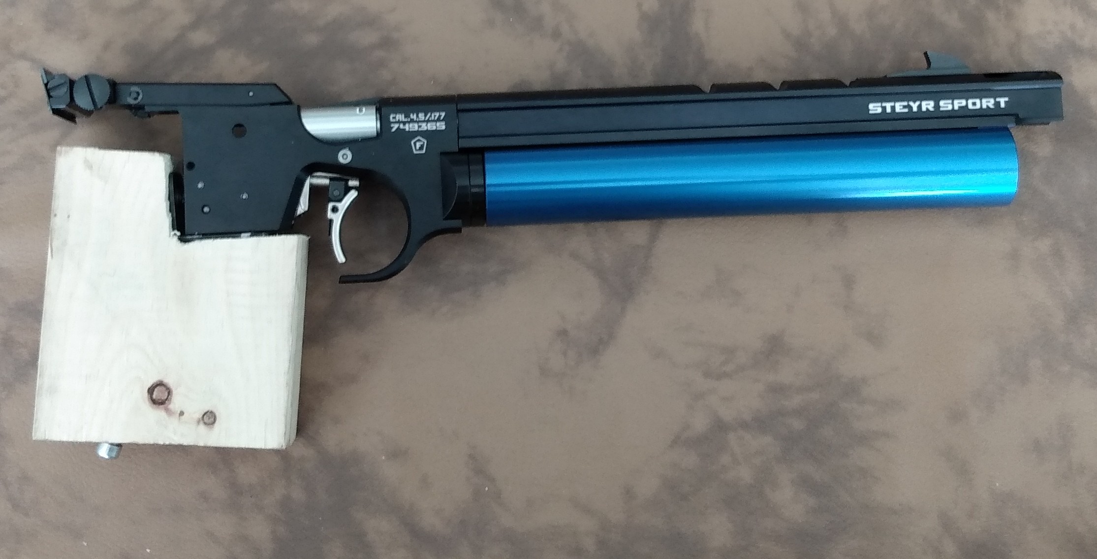

I could not bring myself to clamp any part of my pistol in a vise, so If am going to try this the next time the shop is devoid of projects.

Just a little more sanding and it will be mint.
Posts: 747
Re: Test Grip
dontshootcritters wrote: Sun Sep 05, 2021 4:07 am Just a little more sanding and it will be mint.
It is only to put in a vise for pellet testing.

Nice grip :)
I will make similar grip for my Toz-35 on the next week.

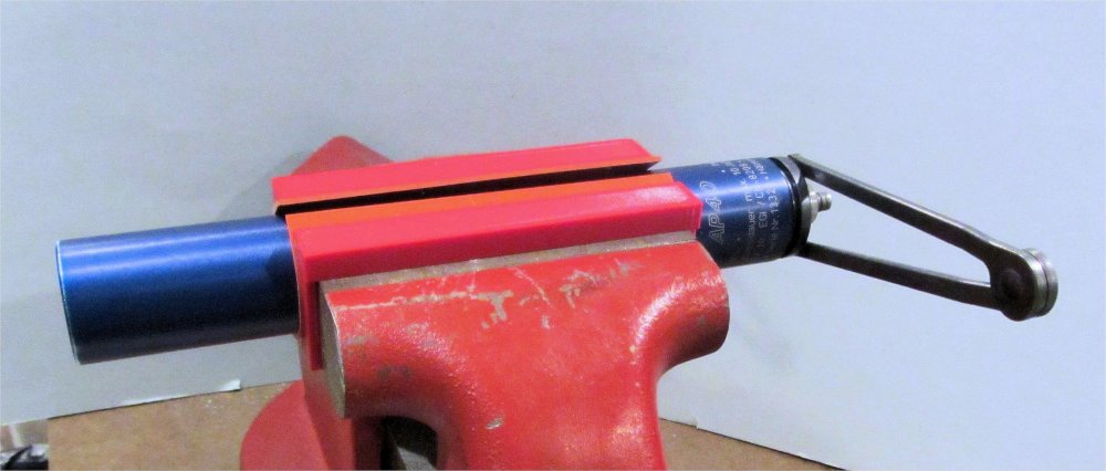

I needed to try to repair/rebuild a Hammerli AP40 cylinder a while back. The problem was hanging onto it securely so I could give a good heave on a pin spanner to unscrew the valve assembly. I 3D printed a set of vise jaws:
Hammerli AP40 Cylinder Vise Jaws.pdf
(128.85 KiB) Downloaded 157 times
I've also got designs to fit Steyr, Morini, & Benelli Kite cylinders. They would certainly be secure enough to ensure good accuracy for testing.
The designs I made are very specific to the vise I have, but the critical cylinder gripping geometry is very simple. You just need to add space for the silicone rubber sheet to the cylinder diameter.

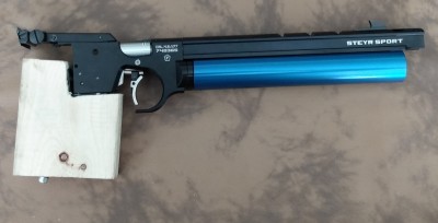

Since some of you thought I was making a grip, here is the final result of my efforts. Since I have a case of RWS 4.49, I didn't want to pellet test. I varied velocity until I got the best groups with what I already had.
