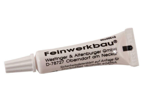

Yup, that small tube of grease. It will work on all FWB airguns (spring, CO2, SSP's and PCP's) and other match air rifles/pistols brands as well.
