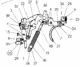

Re: Trigger adjustment Hammerli SP20
trigger group.jpg (32.23 KiB) Viewed 4011 times
The Hammerli 280 and the SP20 use the same trigger cassette.
Screw 8 is the first stage weight on the sear bar.
36 is the co-axial 2nd stage unit, 29 (inner) is the 2nd stage weight and 36 (outer) is the 2nd stage position or point.
15 is the sear bar travel used in conjunction with 28 trigger forward travel to set transfer bar clearance for trigger reset.
28 is the trigger overtravel stop.
To increase trigger weight on 1st stage screw 8 in clockwise.
To increase 2nd stage weight use inner allen screw 29 in clockwise.
