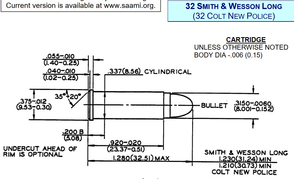

Bullet size for the .32 SW long is a bag of worms, it has the worst SAAMI spec of any cartridge.
Diameter is anywhere from .309" to .315".
Revolvers are Manurhin .311"-.312" up to SW .315"-.316"
Auto's are FAS .310"-.312" up to Hammerli .313"-.314"
Slug your barrel to find out the size.
Use soft lead bullets .001"-.002" over barrel size.
Check/alter dies to match bullet diameter.
Best of luck....

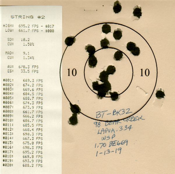

I forgot, there is an outfit named Bear Creek Bullets that offer a swaged 0.314" HBWC.
They almost shot ten ring at 50 yards.
Barrel is an older Pardini HP mounted in a mechanical fixture.

To: fc60
Took your lead and called Bear Creek 30 minutes ago, Yes, they do have some inventory of 98 gr HBWCs. These are cast, then swaged at 0.314". Since I can't locate my Speer HBWCs, I ordered a bunch. Price is reasonable IMO and shipping is flat rate PMail.
I'll be comparing the Magnus (now OOS) to the Buffalo Creek in my Hammerli SP-20 as soon as the weather warms a bit.
Thanks for the referral.

Attn: fc60
Just received my order of 98 gr 0.314" HBWCs from Bear Creek. Very satisfied with appearance and consistency of weight and dimension.
Thanks for the referral. Now I can stop hunting for those Speer bullets.

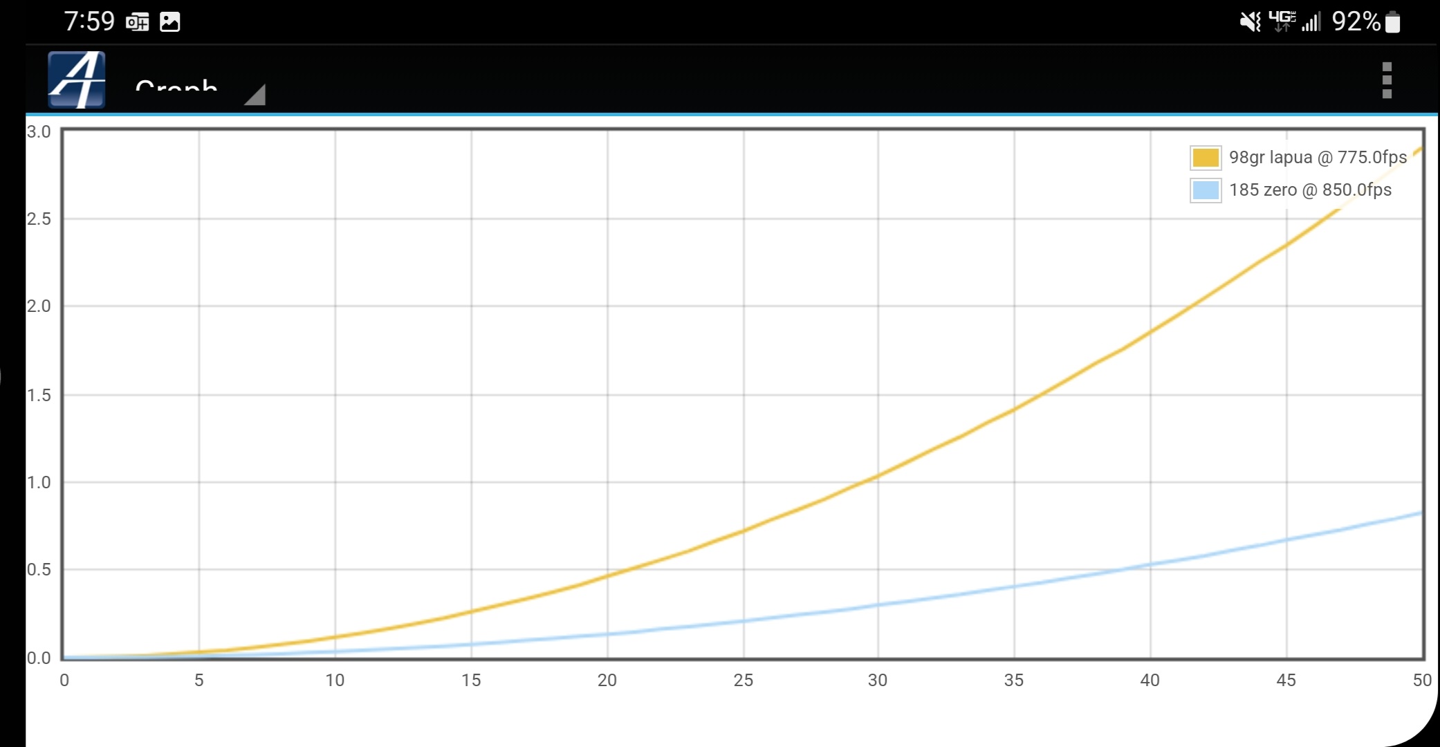

I really like shooting the 32 but to be honest you're really handicapping yourself if you're shooting the 32 outdoors. When I got mine I was also thinking of possibly shooting it for center fire, and listened to some older guys talk about how bad it was and drift. 1st thought was we don't worry about drift in Bullseye then I did some ballistics. With a 10 mile an hour crosswind on a 98 gr lapua at 775fps you're drifting almost 3 Inches in a 10 mph crosswind That takes you from an X to an 8 (9 ring diameter is 5.5" so 2.75 from center). And you have a smaller diameter bullet so you don't benefit from a bigger hole on close shots. Mat not seem like much, but the 45 is .13"bigger so you get 1/16 more scoring area. That's a lot thicker than the line on most targets.
Sure it's only 30 shots for slow fire, and not all will be affected by wind so let's say 1/4 (7 shots) are. You willing to give up 14 points on the long line to start the match?
The bigger issue to me is that it makes you start to question your calls. Ir even worse, blame wind for a bad shot that you don't want to admit.
It took me 15 minutes of ciphering to come to the conclusion that most high level shooters already know... shot 45 for cf...

Very interesting info and certainly a proven for those shooting the 32 S&W Long at Perry where the weather and wind often test the mettle of the best shooters. Don't know about Atterbury.
The 32 ACP is different. A lighter, and different, bullet than the 32 S&W Long but better at 50 yards. When Emil Milev was at PardiniUSA a few years ago, he shot an 873 with a Pardini HP 32 ACP at Perry.
I don't have to deal with crosswind at any of the 4 area bullseye ranges in Virginia & Maryland which is an obvious advantage and factor for me.

Your lucky... 10 mph is a calm day where I live...
