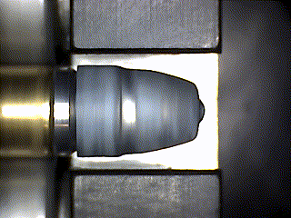

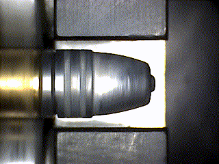

That's right, Eley Team is Eley Tenex depending on how well the machine runs.
- 20210104165322(1).gif (306.16 KiB) Viewed 4998 times
- 20210104165243(1).gif (240.95 KiB) Viewed 4998 times

Great videos. Disturbing, but great.
