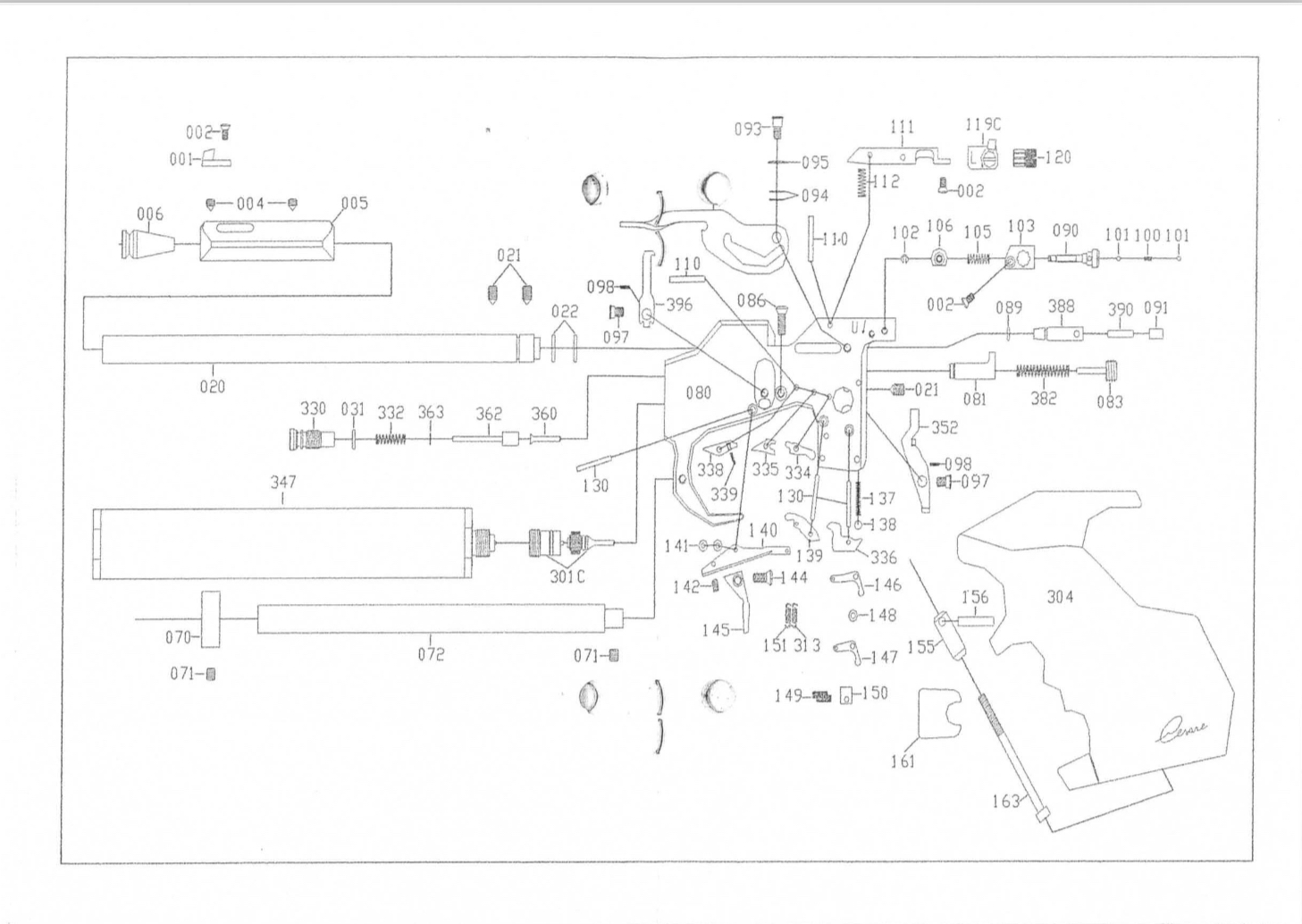

BA_LP_M10_DE 9.pdf
(169.83 KiB) Downloaded 509 times

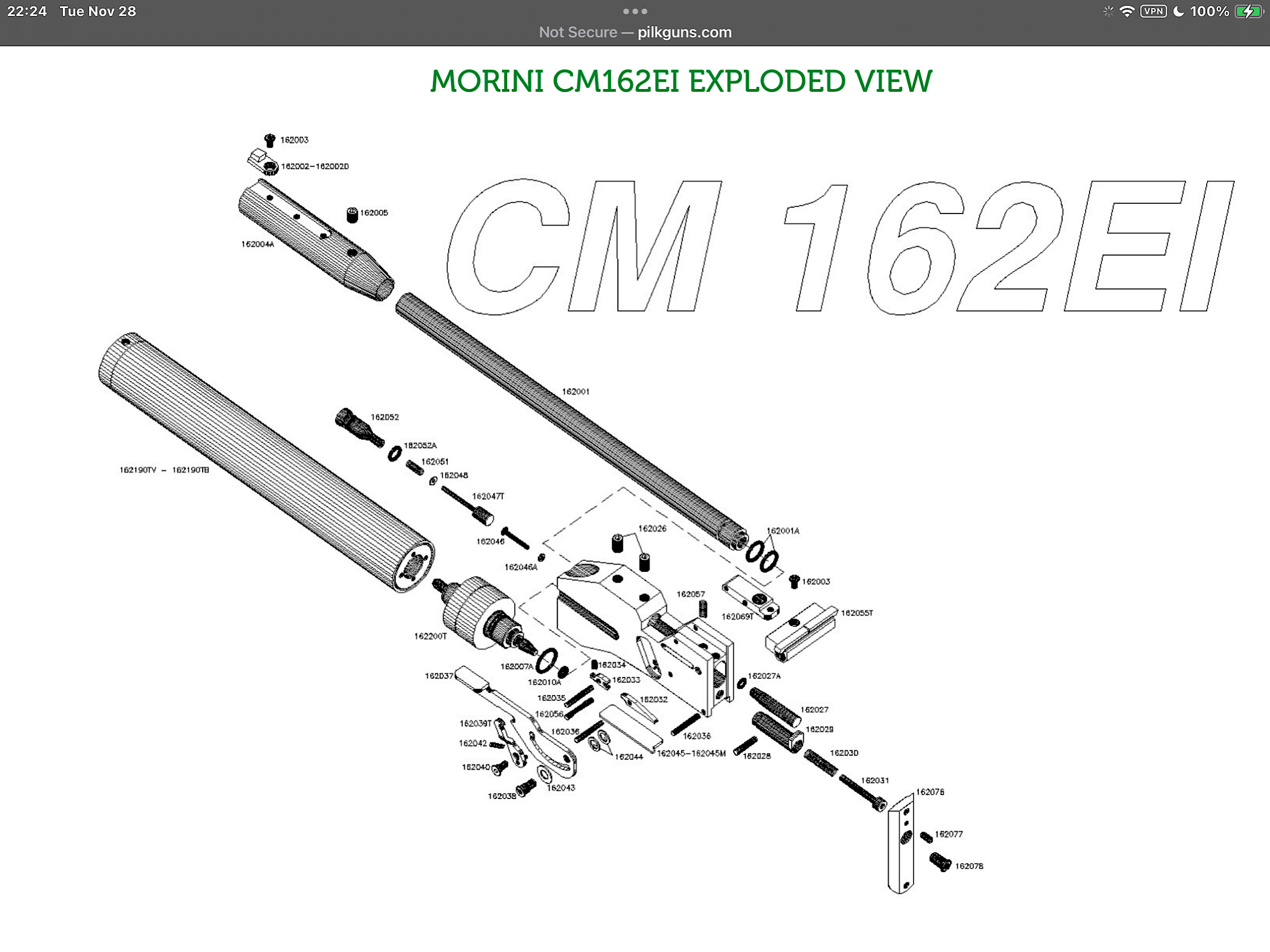

got a part breakdown, I need part 362 or at least the dimensions of the phenolic head of the part and length of stem exposed.

Parts diagram for M10 added from B,S,T post- for future reference.

Looking at the M10 diagram and the Morini 162 ei diagram, it may be possible that part 362 on the m10 is the same (or close) as part 162047T, on the 162EI. It also makes sense as C. Morini designed both pistols...

Thank you, good catch. I emailed Morini and asked if they maybe interchangable or easily modified to work. Hopefully they will respond with good news. Design looks very similar on many parts.

contacted Morini and they told me the parts are not the same. Heres there response. really surprised as there are alot of parts that look the same.
"Actually Morini CM 162EI and SAM M10 are two completely different pistols and for sure the parts are not the same.
Cesare Morini was working in the Morini company and then left and opened SAM in the same place, but we had nothing to do with him."
