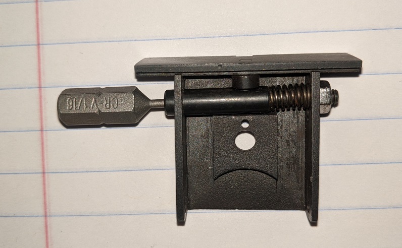

I found my MP95E sight and yes, it looks like the adjustable sight will work per GWhite's fearsome instructions.
Here is a photo - the pin that holds the blade to the bracket is at the top of the photo, at the center of the sight blade (there is some sort of bushing on mine, additionally in-between). The pin is trapped by a setscrew in the center of the adjusting rod, and I can confirm that GWhite's suggestion of using a 1/16" hex key makes a perfect, tight fit. A 1.5mm has some significant angular wiggle. Never mind the 3mm nut on the right - I can't find the Benelli adjuster!
