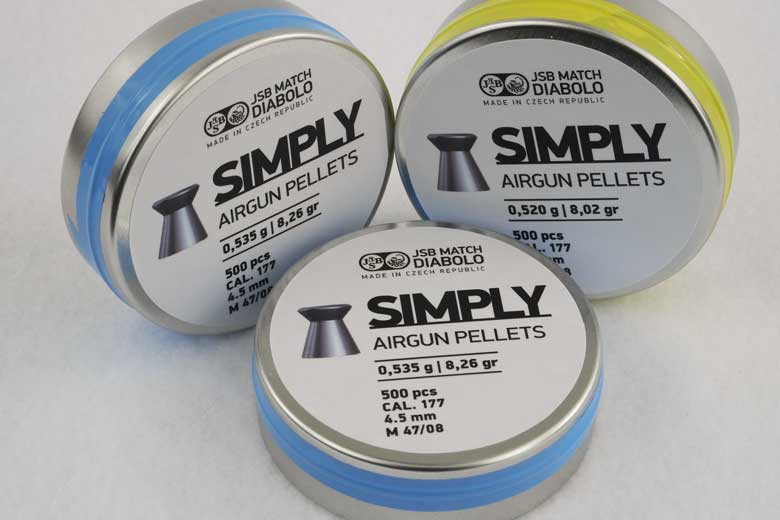

New JSB Simply Airgun Pellets for Practice & Plinking
- Posts: 953
- JSB Simply Airgun Pellets.jpg (36.8 KiB) Viewed 7163 times

Too bad they are not offering lightweights in this series.
The thing that appeals to me is that they put the foam pad in the pellets. For my shooting, I count the pellets into the lid (with foam) and then shoot a string. The pellets don't roll around, are easy to pick up, and are protected as well.

Kevin, agree these might make an interesting comparison to the RWS Basics. I would probably buy a tin or two but they don't seem to be available in the US yet, no pricing either. Can you get them in Costa Rica? Agree with Rover that the lightweight 7.33 and 7.72 grains need to be added to the lineup.

Gwelo, there are no JSB retailers here in Costa Rica. There is a Cometa airgun representative who also sells “Cometa” pellets (rebranded JSB). I don’t see them here neither, in Europe and parts of Asia they’re already selling them.
JSB virtually makes more pellets for rifles than for pistols, that might be the reason for the Simply offerings in “heavy” weight. The Basics are my favorites as well, having a very good cost-performance ratio.
It’ll be interesting to do a test when they hit the shelves in the U.S.!
