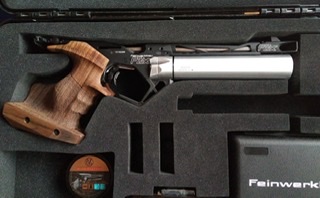

Re: Feinwerkbau P8X review: how to improve it?
Compact P8x where through clever design the sight radius can be the same as the long version.
I cannot imagine how a pistol could be any better or more sophisticated, especially the trigger which I consider to be absolute perfection!

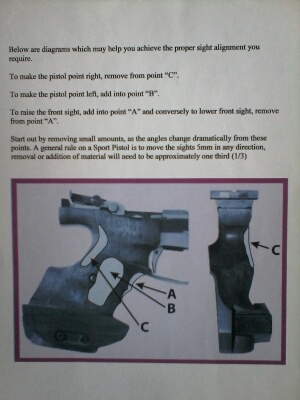

Besides, I was teached that horizontal and vertical correction of front sight position should be made by adjustments on the grip. I'm not sure if it was a good advise but i believe it was (the person who did that has a LP10). What do you think?
Major problem for me is sometimes it seems i cant a little. For that i don't know how to adjust the grip. Anyone knows how to?
Here are the instructions i have for grip adjustments:
- alterações Punho.jpg (40.91 KiB) Viewed 96851 times

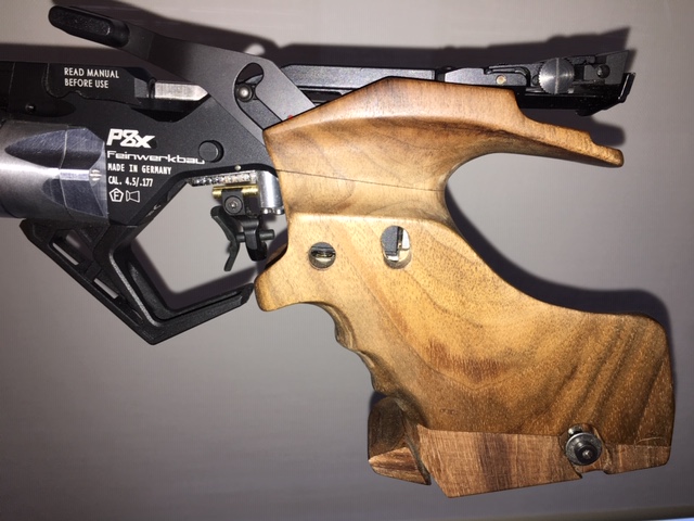

I've owned and regulary shot 162EI, LP10, and LP400. The 162EI was my favourite before the P8X.
The adjustability of everything on the P8X is unmatched by anything else out there.
The P8X factory grip as supplied (large) was mostly fine but needed some putty in places, and the part where the end of the thumb came was too short so the edge dug into the thumb which was a distraction.
The Rink grip (unstippled) is XLRF7 size and has adjusting screws similar to the factory P8X grip. You can see the split line where I removed 2mm to lower the top beavertail down. The pivot insert inside the grip was machined down to get the gun lower into the grip. The factory trigger still sat a bit high even after all the adjustment was taken up so I made an adaptor to lower the trigger assembly. The P8X trigger shoe is a bit short and the ends dug into my finger pad (another distraction) so it was replaced with a metal Walther GSP trigger shoe which has a longer face. The holes in the side of the grip allow you to view the screw adjustments that bear against the gun. The sights are canted a little bit (bottom of grip canted to the left). The result is a gun that gives me the best mental connection with the job in hand.
