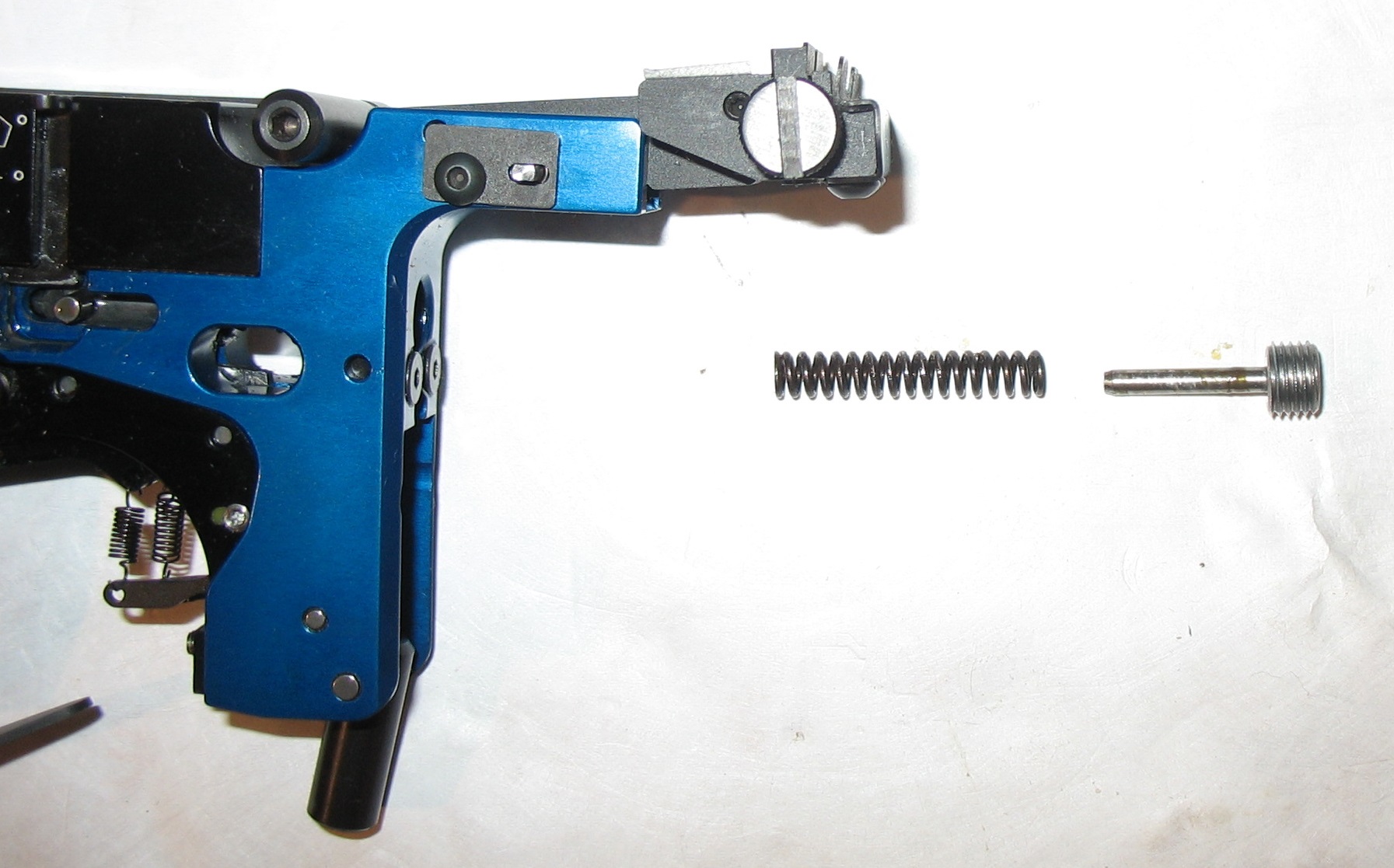

Post by Heavypellet »
I took out the hammer spring and spring guide also came out. They both look brand new. I reinstalled them and put tension screw back in, no change, adjusted the screw, very little change, much more change when I adjusted the air pressure regulator screw. Still waiting for Match Guns in Italy to reply. They said they are still in Virus shutdown mode until maybe April 9, maybe.

Re: Need Help to Diagnose problem with my Match Guns MGH1
See attached picture.
Post by trev »
I have an MGH1 and I have found the velocity changing on it own. I set the velocity to 535 fps and it was very consistent over 15 shots it varied just 2 fps but two weeks later it sounded soft when I shot it. After checking the speed again, I found it was recording 467 fps when adjusting the part to increase the velocity it moved very easy with no resistance. When adjusting an LP10 there is a small grub screw that locks the adjusting screw but on the MGH1 there is no such screw they just hope the spring compression keeps it stable. I think Match Guns should think about a locking screw on the velocity adjusting screw.
Having seen the picture on the previous post I am now going to remove the adjusting screw and check the spring.
