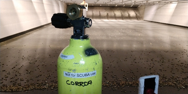

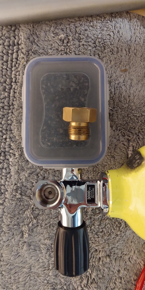

The typical setup for 200 bar cylinders starts with a SCUBA tank with a "K"" valve, and then you buy a K valve to 200 bar DIN adapter. You can get a straight DIN valve, but they are usually 300 bar. You need a DIN plug adapter to fill 200 bar cylinders, and SCUBA shops will automatically refill the tank to 300 bar unless you specifically ask (and watch them). That can be risky, and eliminates some nice options (like a good gauge and a bleed valve).

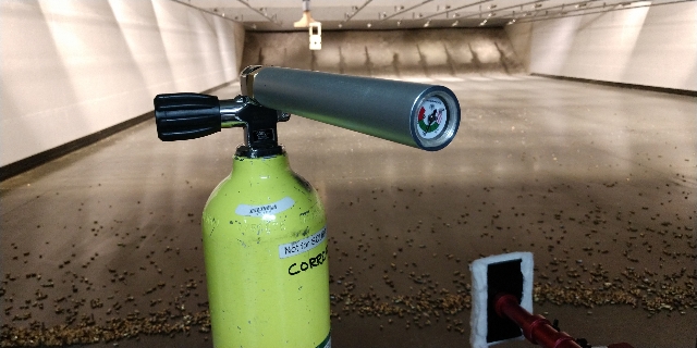

The nicest setup (which may be overkill for you) is a fill adapter with a good pressure gauge (the ones on the cylinders are notoriously variable), and a push button bleed adapter from Best Fittings in England:
https://www.bestfittings.co.uk/shop/air ... ton-bleed/
You want the one with no hose. Depending on the brand of cylinder, you can either fill it, close the tank valve and then hit the push-button bleed valve, or you may have to unscrew the cylinder a turn or so and then bleed it. Removing the cylinder the rest of the way with no pressure on the threads saves a lot of wear & tear, especially on aluminum threads.
Next, you need a 200 bar DIN adapter:
https://www.bestfittings.co.uk/shop/fil ... -bsp-male/
If you ask, they will assemble them for you. I ordered the 2 pieces separately and ended up without the high pressure washer that goes in between. The team I coach now has three of these. The gauge is especially important if your cylinders have no gauge (like Hammerli AP20's & 480K's)

You still need a DIN adapter, but you can take that off the Hill pump. As said, buying a tank system whose pressure rating far exceeds your cylinders rating will give you more fills, but one slip and you are dealing with a bomb.
What I'd love to see is a fill adapter with a fixed 200 bar limiting regulator that would allow safe use of high pressure SCUBA tanks. Best Fittings has paintball tanks with fixed regulators, but they are all for lower pressures. I just sent a suggestion to Best Fittings that they investigate supplying such a setup.
The team I coach has four SCUBA tanks (soon to be 6), all of which have to be filled to 200 bar. That means a lot more trips to the SCUBA shop to get them filled than if we could use 300 bar tanks.
