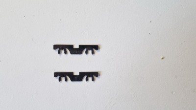

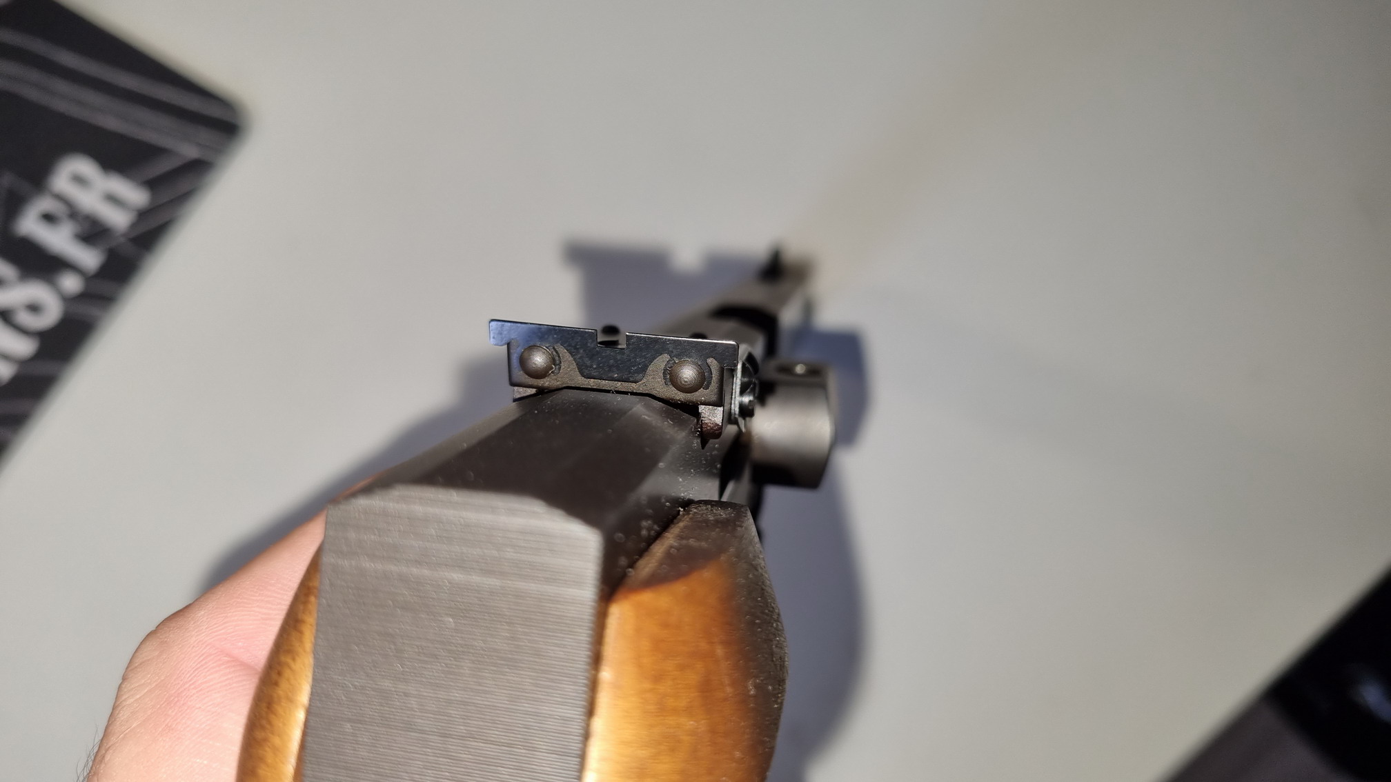

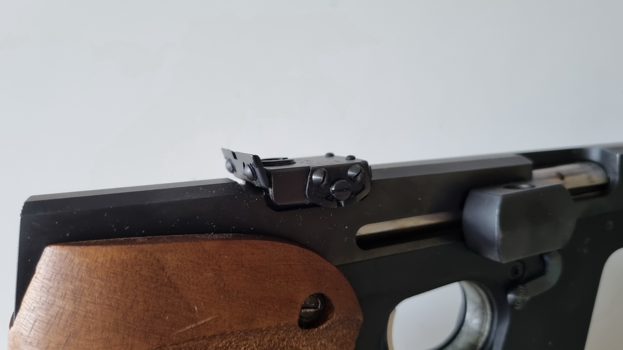

Posts: 454
Re: Help assembling/mounting Walther GSP rear sight
hi
i recently acquired a very old Walther GSP (from 1976). it came with some spare rear sight blades.. and i;d like to change it.
however, the mounting system is different from the one presented here.
anyone know how to remove the currently installed sight blade? (i have not found a manual version so old that it matches my pistol)

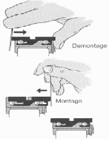

David Levene
Posts: 5617
Location: Ruislip, UK
Post by David Levene »
The old site blades slid off to the side.
I'm not sure whether the newer blades will fit on the old pins.
Posts: 454
David Levene wrote: Mon Aug 16, 2021 6:00 am The old site blades slid off to the side.
these ones are even older. they seem to go in from above. the installed one and the replacement use the same system.
however, getting the currently installed one off by pulling up at the corners, does not seem to work

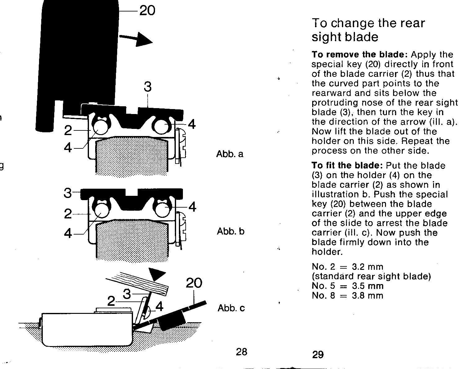

fc60
Posts: 759
Post by fc60 »
Walther used to supply a Multi-Tool for removing the rear sight blades and adjusting the sight screws.
With the old style you put the Multi-Tool underneath the replaceable blade and levered them upward.
The old and new style rear blades are interchangeable.

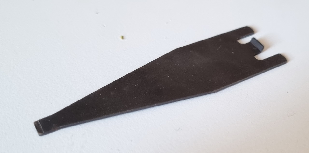

Posts: 454
fc60 wrote: Mon Aug 16, 2021 10:14 am Greetings,
this one?
fc60
Posts: 759
Post by fc60 »
Yes, that is the "Special Key".
Support the main housing as much as possible to prevent twisting it.
Here is an image from Manual 1273.20.3 217 21 51...
