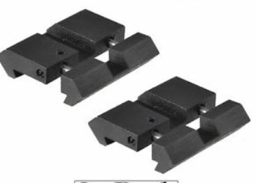

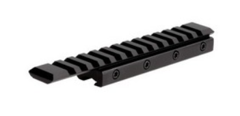

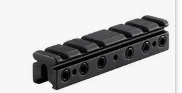

Here are some examples.
ProdigalSon wrote: Wed Feb 20, 2019 1:03 am Recall that your KK500 is around 6 kg. Assuming you're using the normal ammo for the gun (i.e. standard velocity lead 40gr), the recoil velocity is a bone-crushing 0.13 m/s and the recoil energy a mind-numbing 0.05 J. Iron-sight shooters just clamp the sights right onto the 11mm rail, and some even remove them when they're done for storage. It doesn't take much to hold on to that rail under those recoil conditions, so just about anything will work well as long as it fits and the metal isn't so weak that a snug fit damages the threads (which is unlikely unless they're using a 1000 series aluminum or you overtorque) - it's not a situation where rugged, heavy-duty mounts like you'd see in PRS are really needed.
The Walther barreled action will be put in a custom stock, not sure what the final weight will be. Periodically, the scope will be moved over to a 6mmBR rifle, until I can justify another scope, which sets some additional constraints.
I won't switch often, so I am open to a system that isn't QR.
If I go the non-QR route, maybe I should just go with rings?
