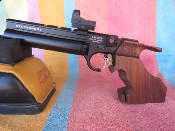

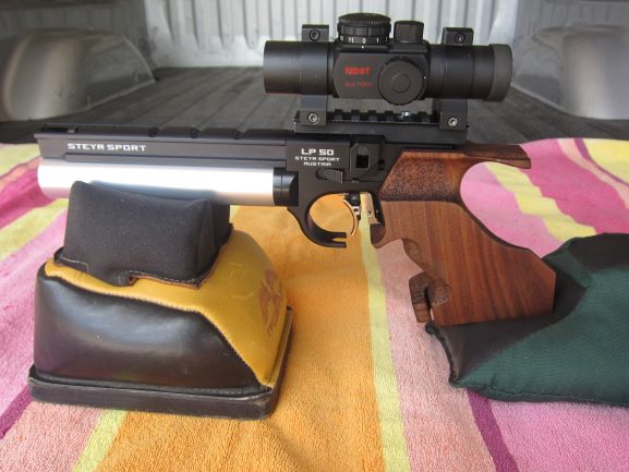

It depends on what type sight you want to use. The Steyr mount fits both as it is in front of the cocking arm (LP10/EVO) and magazine tunnel (LP50). It only has one cross slot for sight mounting so you would have to use a Reflex dot or short tube type as shown in pics 2 & 3. The first photo shows a longer weaver rail mounted in place of the rear sight and a Millett dot (same mtg as Matchdot Ultradot). The mount could be turned around but I have not tried with a LP10/EVO to see if it clears the cocking arm.

The longer mount shown was made using a purchased length of weaver rail cut to length and machined by a friend to fit the LP50.
The rear sight slides over a raised rib and is secured with a single screw, very easy to remove. You can see the standing rib in my pics. Not a proper dovetail but quite sufficient for sight mounting.
