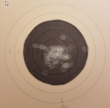

For space reasons, I mostly practice in the garage, with 5m targets I get here:
https://www.ebay.com/itm/106T-5-Meters- ... 2097271052
I have a few questions that perhaps people here can answer:
1) These targets are slightly smaller than the pdf versions I have seen online (printed 1:1, laser printer). Diameter of the 1 ring is 7.8cm and diameter of 7 ring is 3cm (50% of the 10m targets). Which ones are correct?
2) Is there a rule of thumb I can use to correct the scores and normalize to a 10m target? (I expect the score at 5m to be higher)
3) Is there any source of these targets in the US? Kruger doesn't have them, these are specially printed fro Cibles Canada and shipping can be expensive if you only buy a few.

Re: 5m scaled down targets
For reduced distance practice i calculated the diameter of the black at my reduced range of 7m which is 42mm.
At 5m the diameter of the black will be 30mm (5m/10m x 59.5mm = ~30mm).
Then i cut a 42mm diameter hole in a target and use it as a template to make black discs on the backs of targets using a fat sharpie.
Luckily for scoring a 7m reduced size target has been posted on TT here: http://www.targettalk.org/images/Attach ... Target.pdf
I used it to create the attached pdf which I had printed on a transparency to overlay on the shot target for scoring. The pic shows the general idea (the pic is 7 stacked photos, 6 shot targets and 1 of the scoring rings).
At 5m use the info in this thread to calculate the adjusted scoring ring sizes (cause while the target can scale the pellet doesn't): http://www.targettalk.org/viewtopic.php?t=29348
At 5-meters: Use air rifle target (black = 30.5mm actual).
Compared to "apparent" size of half-range pistol target ( black 59.5mm / 2 = 29.75mm)
Saves a whole lot of money.
It may be that the scaling is too extreme at 5m, because if you adjust so the score will be roughly correct, the black will be noticeably smaller. People just need to be aware that scores on a linearly scaled target without bullet size compensation will be overly optimistic.
As an example: To scale a 10m air pistol target with a 5.95 cm diameter black to 5m for 4.5 mm pellet diameter, shots that just touch the black at 10 meters will have their centers on a circle 5.95 cm + 0.45 cm = 6.4 cm in diameter. That scaled to 5m will be 3.2 cm in diameter. In order to have such a shot just touch the black on the reduced target, the black must be 3.2 cm - 0.45 cm = 2.75 cm in diameter. That means a simple linear scaled black would be 2.25 mm larger than a black that would produce the same score.
> They may scale the target linearly, and adjust for the bullet size in the software
If you estimate the center of the shot, it should be quite easy to scale down the bullet as well.
What I have been doing so far is subtracting 20 points to the final score (for 60 shots).
The rationale is the following (I am not considering the 10 - 11mm diameter - and the math could use a second look :-) )
In a regular target, the circles are 8mm wide.
You score P if the center of the pellet lands between 2.25mm and 10.25mm to the right of the P+1 circle
In a 5m (50%) scaled target (4mm wide circles)
With a 50% scaled down pellet on a scaled down target, you score P if the center of the pellet lands between 1.125mm and 5.125mm to the right of the P+1 circle.
however, with a full size pellet, the score will be
P+1 when the center of the pellet lands between 1.125mm and 2.5mm to the right of the P+1 circle,
P when the center of the pellet lands between 2.5mm and 5.125mm to the right of the P+1 circle
The fraction of shots that are correctly scored on a 5m scaled target with regular size pellets is
(5.125 - 2.5) / (5.125 - 1.125) = 0.66 (66%)
and the fraction of shots that are overscored by 1 point is 34%
If this math is correct, a rule of thumb could be to subtract 20 or 21 points to the final score (60 * 0.34 = 20.4).
Makes sense?
Caveats: This works if the distribution of the pellets is uniform (like in my case :-) ). Once you start having very tight groups around the 10, the overscoring can be much higher than this.
