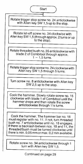

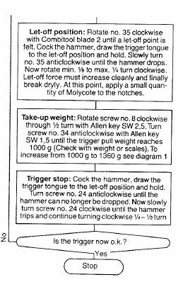

Attached is the flow chart for the model 280 and, also, the SP-20 as an example of good documentation.
A good start.
What are the parameters for adjustment?
i.e. Hold trigger back and move screw "D" until hammer falls then add/subtract 1/4 turn, or 1/8 turn.
- 280.jpeg (39.97 KiB) Viewed 2693 times
- 280B.jpeg (33.34 KiB) Viewed 2693 times
