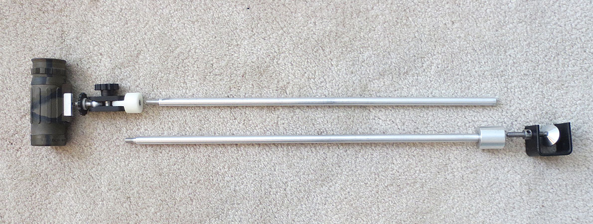

For many years I used a simple Tasco #567 monocular (8x25) mounted to a telescoping monopod that clamped to the shooting table. Everything fit within my pistol case.
The current equivalent is a 10x listed here for under $10 USD...http://www.ebay.com/itm/like/1724314514 ... rmvSB=true

Coolmeester wrote:
DFWdude wrote:For many years I used a simple Tasco #567 monocular (8x25) mounted to a telescoping monopod that clamped to the shooting table. Everything fit within my pistol case.
Does that have any threads for mounting it to stand/tripod? I didn't see that monocular mounted in any picture I googled..
Do you have pic of that telescopic stand?
Memory fails me... not telescoping, but a threaded assembly. Add a C-clamp at the bottom, the two rods, the adjustment assembly from a cheap tabletop photography tripod, then the monocular.
