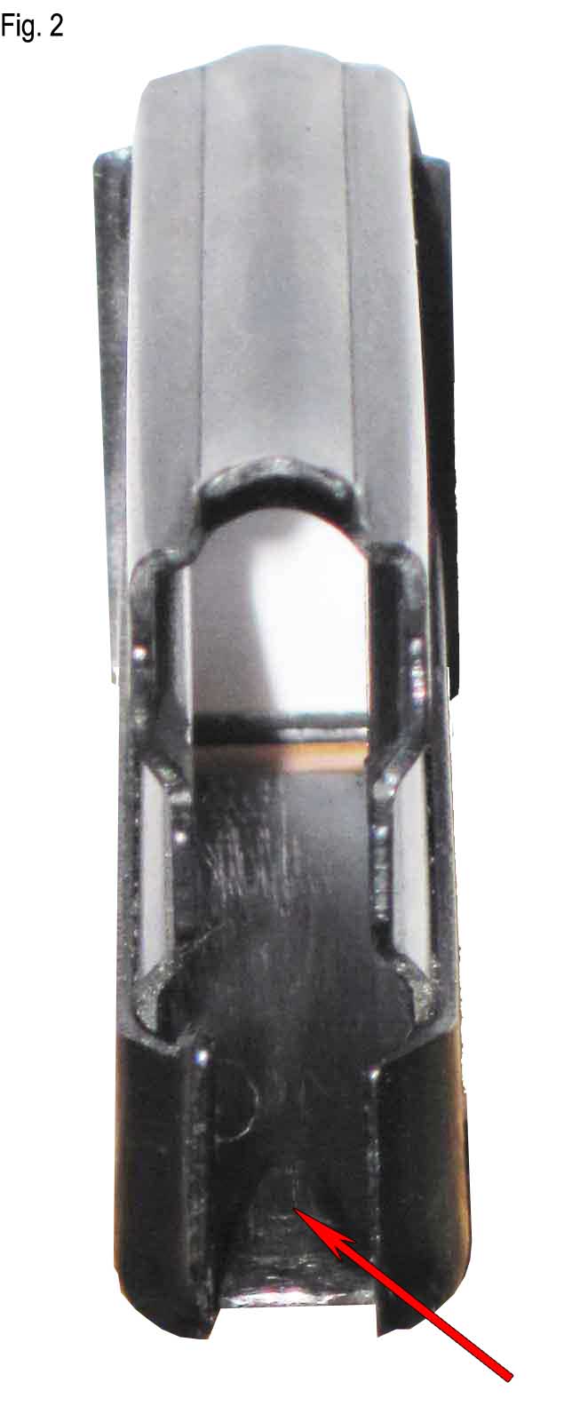

Would you please post a picture of the modification? [This is done by choosing a file in the "Upload attachment" box below this one, select your image file (save as a .jpg), and then click "Add the file."] Thanks much, dipnet

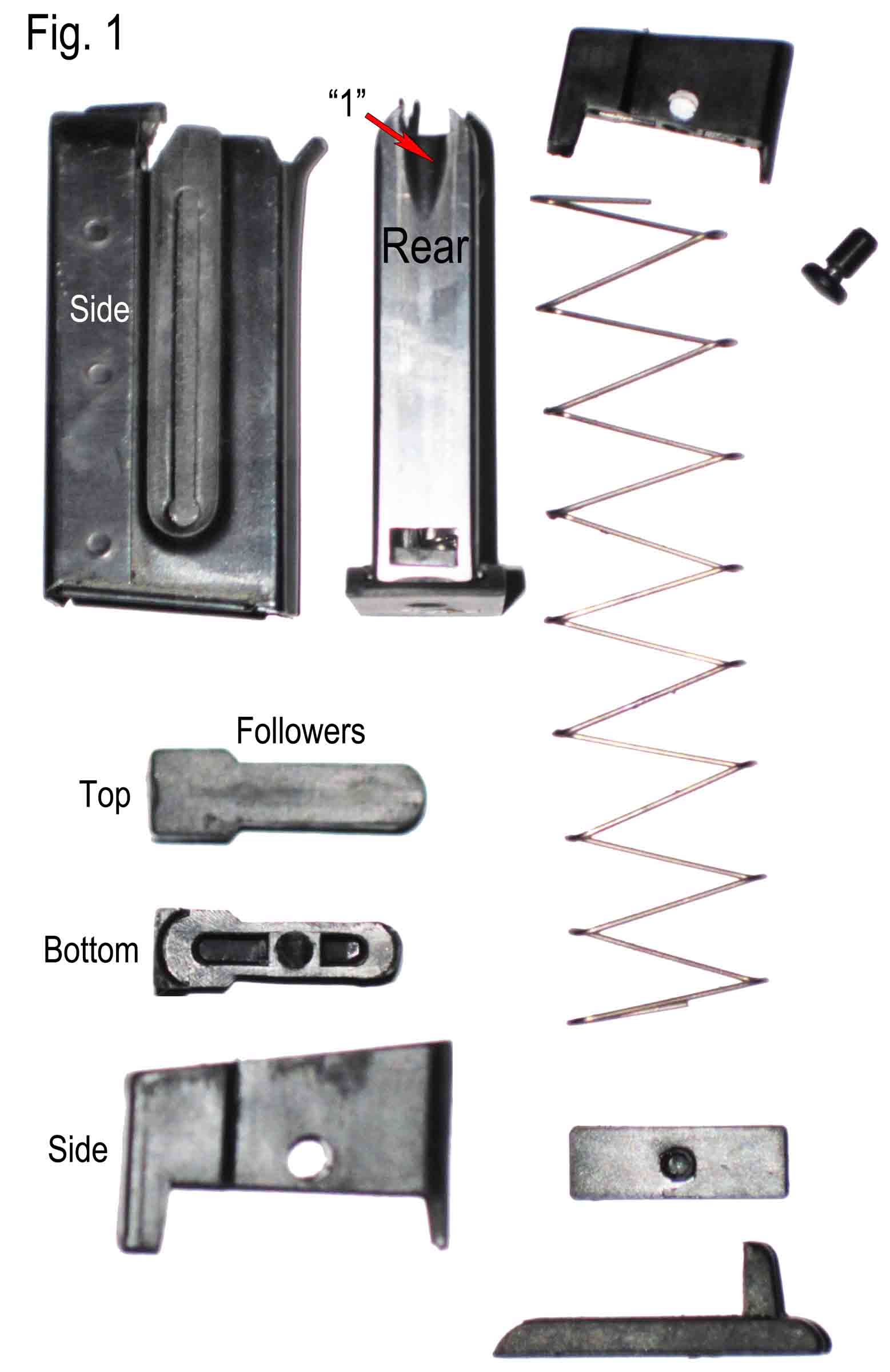

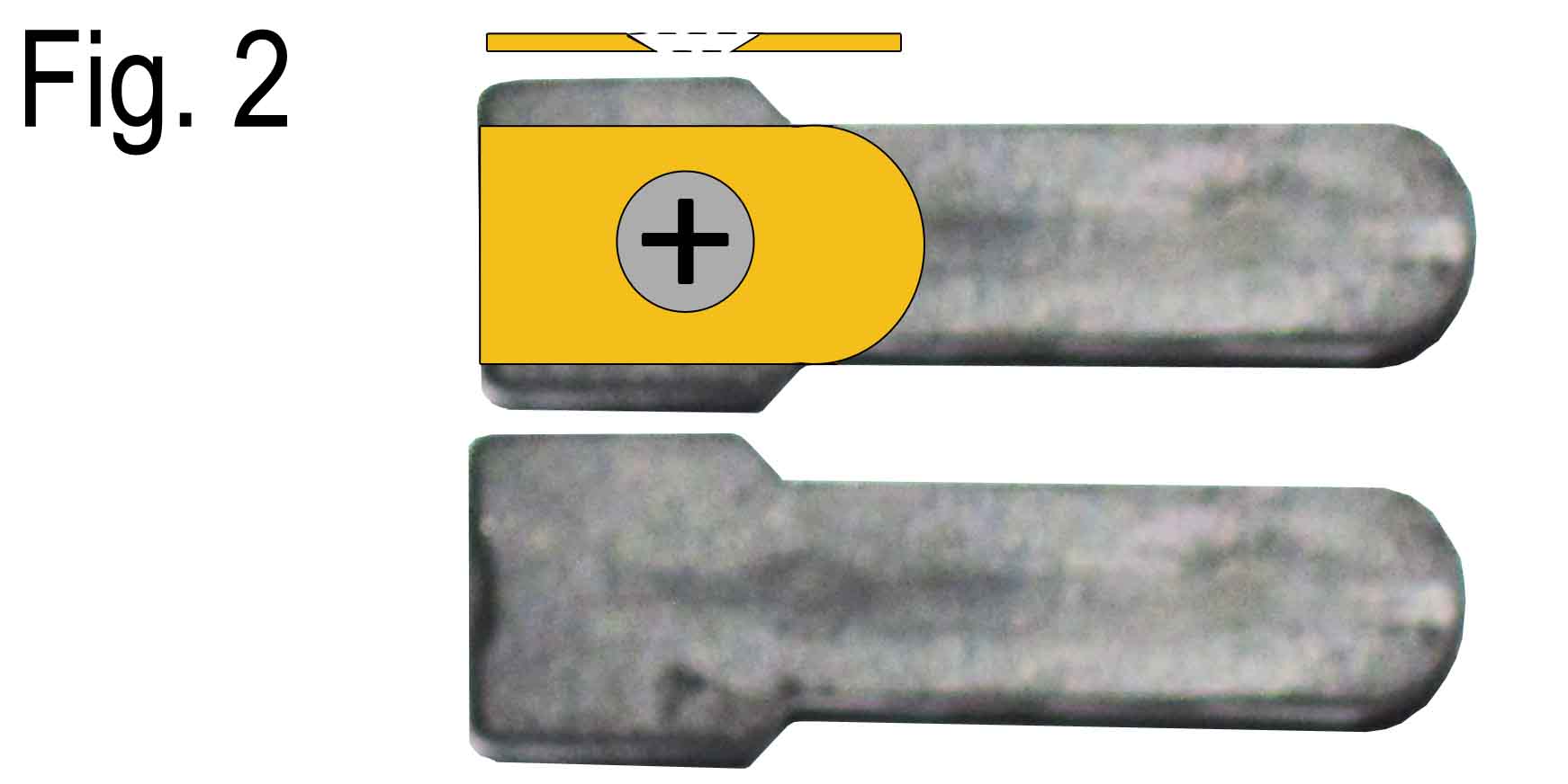

I've read and re-read the description of the mag and get the gist of the idea, but stumble at understanding some critical points, namely:
1, "...grind off one end of it [bolt stop plate] to the shape of the rime of a .22 case (not critical)." See Figs 1 & 2 showing my interpretation.
2. Remove the follower and find the location of a hole to drill that'll let about 1/8-inch protrude above the follower. How can it protrude 1/8-inch above follower when the bolt stop plate is only 0.018 to 0.025 inches thick?

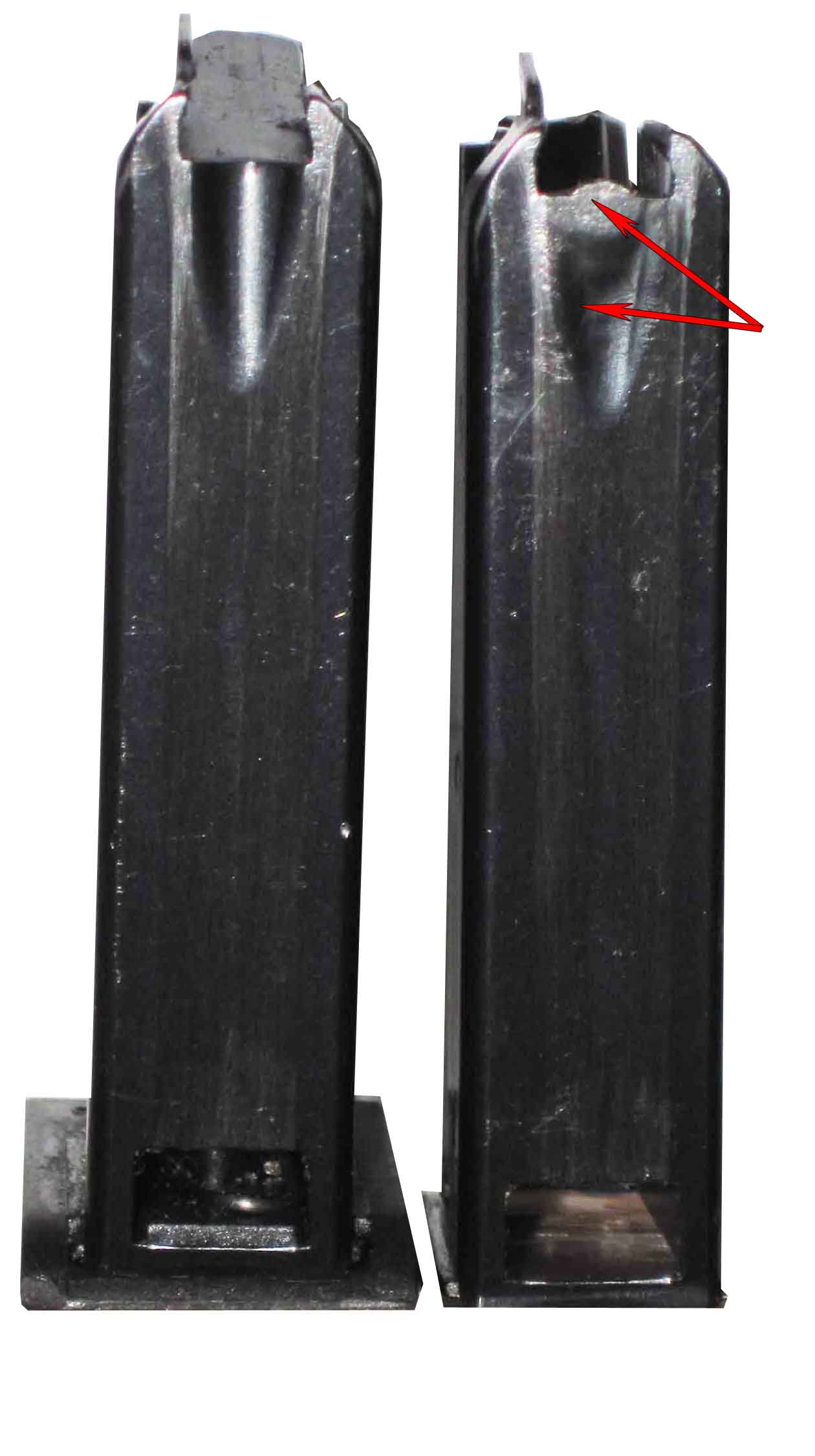

3. Is the "dimple" you refer to a V-shaped groove at the top rear of the magazine (see Fig. 1, "1"). Why does that need to be flattened?
4. I'm guessing that the "shape of the rim is simply a rounded front (or rear) of the bolt stop plate.
5. Should the "bolt stop plate" be placed flush to the top-rear of the follower or located slightly forward?
I want to make this modification, but considering the price of the SP magazines, I want to get it right. I do carry a spare firing pin, but would hate to change it in the middle of a match. Thanks for your help. dipnet

I sent the above query to Ed Hall, and asked if he could forward it to Robert Brown and Ed kindly provided the following explanation, which makes sense.
"Dipnet"
Unfortunately, Bob passed away a few years ago, so he can no longer help us.
From looking at your Fig.2, it appears you are understanding the steel to be on top of the follower. The positioning is actually along the vertical back of the follower. This allows the rounded end (toward the right in Fig.2 top) to take the place of the rim of a .22 case, when the mag is empty. I don't have a Pardini, so I can't provide any pictures, but if you use the lower (Side) image of the follower in your message as a reference, the steel would be placed vertical along the back edge (left in picture) where "Side" is shown. If you look at your magazine, with a .22 round in it, from the back, the rim of the round fills the opening between the lips. The new piece of steel will fit in that area in the same way as the .22 rim, when the mag is empty, but it needs to allow for stripping of the last round when not empty, so it needs to clear the bolt on that last round, while catching the bolt after the last round.
I'm not sure, but I think the reference to the dimple is to show how much material to remove from the rear surface of the follower to allow for the steel to have room in the magazine tube.
I hope this was helpful. Let me know how it works and, if possible, please provide me with some pictures. I'd like to put some pictures with the instructions, if possible.
Take Care,
Ed
I now understand why the V-shaped groove at the top rear of the magazine has to be flattened with a punch, to make room for the metal placed on the rear ind of the follower. So, I'm going to modify a magazine and will report on the results. Thanks Ed Hall. dipnet

I asked my coach a few weeks ago, and Dipnet has the right interpretation. The steel piece goes along the back of the follower with a raised rounded "bump" to replicate the profile of a loaded cartridge. And, yes, the mod works by having the bolt slam into that steel plate. Seems to have been a popular mod at least at some point. I haven't done it yet, since I'm a bit concerned about the outcome as well!

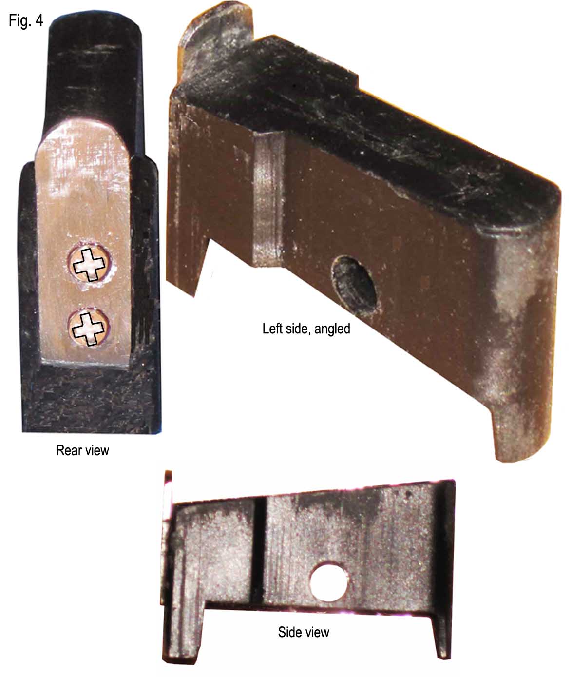

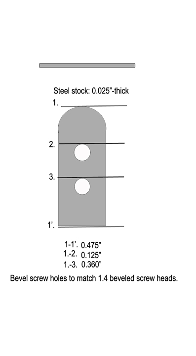

I more or less followed Robert Browns directions and it works great. The magazine locks back after the last shot, and as stated, you have to pull the bolt completely back and lock it before removing mag and inserting a fresh magazine. The one problem I encountered is that I did not use sufficiently strong steel stock (I modified a hinge that I thought would be strong enough; it wasn't). You really need to use hardened tool steel for the tabs that hold back the bolt. I had to hand file the stock to obtain the thickness of 0.025-inches.
Dimensions of tab (inches): 0.220 wide X 0.475 long X 0.025" thick, allowing for the top 0.125-inch of this bolt-stopping tab to protrude above the follower. The upper 1/8th inch is what stops the bolt.

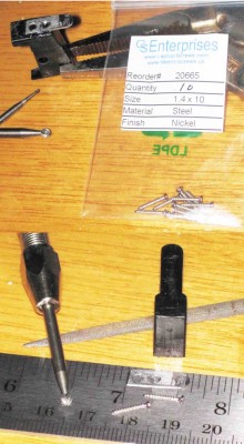

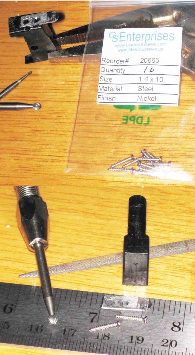

Screws: they have to be micro screws (I used 1.4 X 10mm long self-tapping screws); (see http://www.metricscrews.us [20665, 1.4x10]); this is the only screw that will allow the beveled head to be ~flat with 0.025"-thick stock.
I glued the bolt stop to the follower before drilling holes (using super glue). I used urethane glue ("shoo glue") to fill in cavity in void underneath the follower to help further anchor screws.
The design would have worked if I had begun with sufficiently tough steel; goess I will have to ask a machine shop about making these small bolt stops. Hope this helps. The attached figures should be self explanatory.
In flattening out the "V"-shaped groove at top rear of the magazine, the punch never completely flattened the outside although the inside of the magazine was flat; I also file this area (Figs. 1, & 2).
Fig. 3 shows the micro screws and the dremel bit I sued to bevel the screw holes. I can tie small flies but this minute machine work was challenging. Cheers, dipnet
