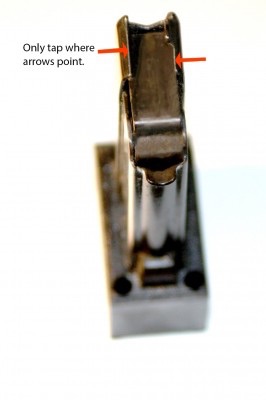

The mag spring or recoil spring is not the problem,
the problem is the lips of the mag are too wide and let the bullet out too soon.
Search my name on this forum for a photo of how to correct the problem. I no longer have the photo.
I shot a match yesterday and not one problem with feeding. I have 5 mags.
It surprises me Pardini has not picked up on this.

Re: Pardini HP .32 acp stovepipe
Use a 9/32" drill as a test Rod.
Tap carefully where the arrows point.
The original posting is titled, "Pardini 32 HP ammo talk"
I cannot take credit for it, this was a big problem and someone else cured it,
I only took a photo to help others.
- image.jpg (15.52 KiB) Viewed 8480 times

tune the mags as described, and use 22 mag springs......and it'll be your favorite gun.
That's all I did and mine runs perfect with any ammo and all loads.

I believe that I need to do the mod to my mag lips. Just to be sure I understand, is the 9/32 drill supposed to stay in the lips until the end as it is pulled out?
