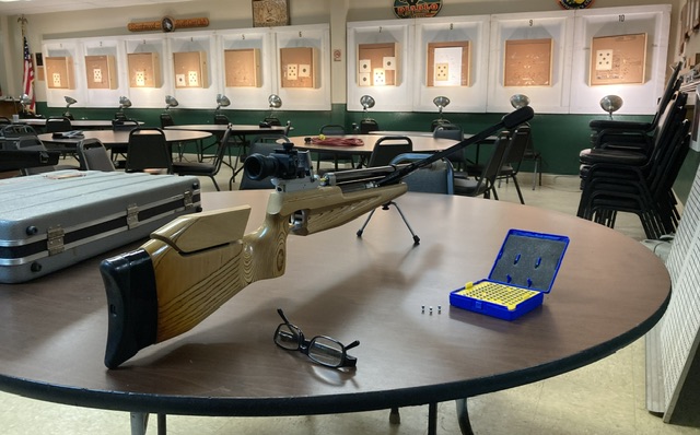

At Diablo, during the winter we shoot indoors.
The targets are on the walls.
Lights are clamped onto chairs in front of and below the targets.
Hopefully you can see the lights in the photo..
